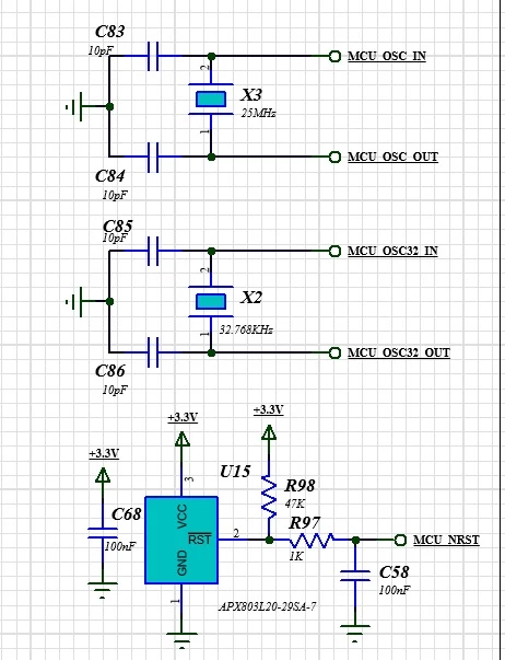

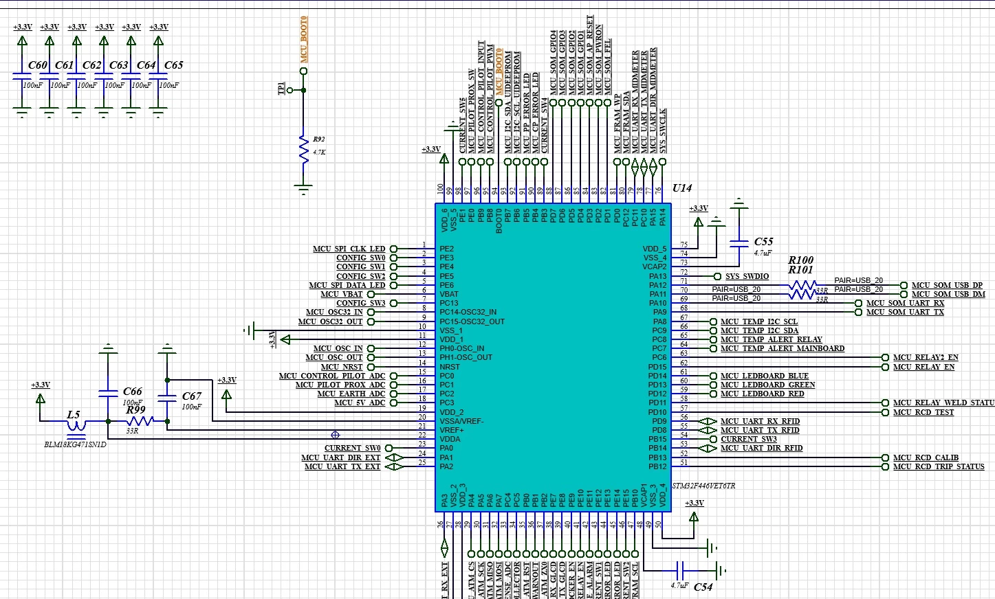

I have designed a circuit with STM32F446. I am using an external 25MHz crystal. The main application program runs fine without any issues, and USB communication works. However, on some boards, I am unable to put the processor into USB DFU mode. I have several boards, and most of them enter DFU mode correctly. I am controlling the Reset and Boot pins externally with another microcontroller. I am monitoring the NRST and BOOT0 pins with an oscilloscope, and there seems to be no problem.
I have also tried using a 10MHz crystal with 20pF capacitors, but still couldn't get the processor into DFU mode. I even tried the UART bootloader method by disconnecting the USB cable, but I still fail to get a response from the processor to the 0x7F command.
As mentioned earlier, DFU mode works perfectly fine on many other boards. However, despite checking everything, I am unable to put the processor into DFU boot mode on some boards.

I see few if any pull resistors on the other pins related to bootloader entry. Maybe some floating pin is toggling and some other bootloader mode is entered.
bymrzAuthor
May 6, 2024
Hi Dear Bonnes. I've double checked the bootloader relative pins. And I pulled high CAN2 Rx pins already to be ensure.

Maybe the crystal has sloppy tolerances and only is inside the USB spec with low board temeratures? Does the crystal oscillate at all or does it start up very slow? Are the 10 pF load for the crystal what is calculated  or is that some standard value you use(AN2867)? Cold solder joints? Some supply voltage at an exteme end?

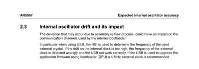

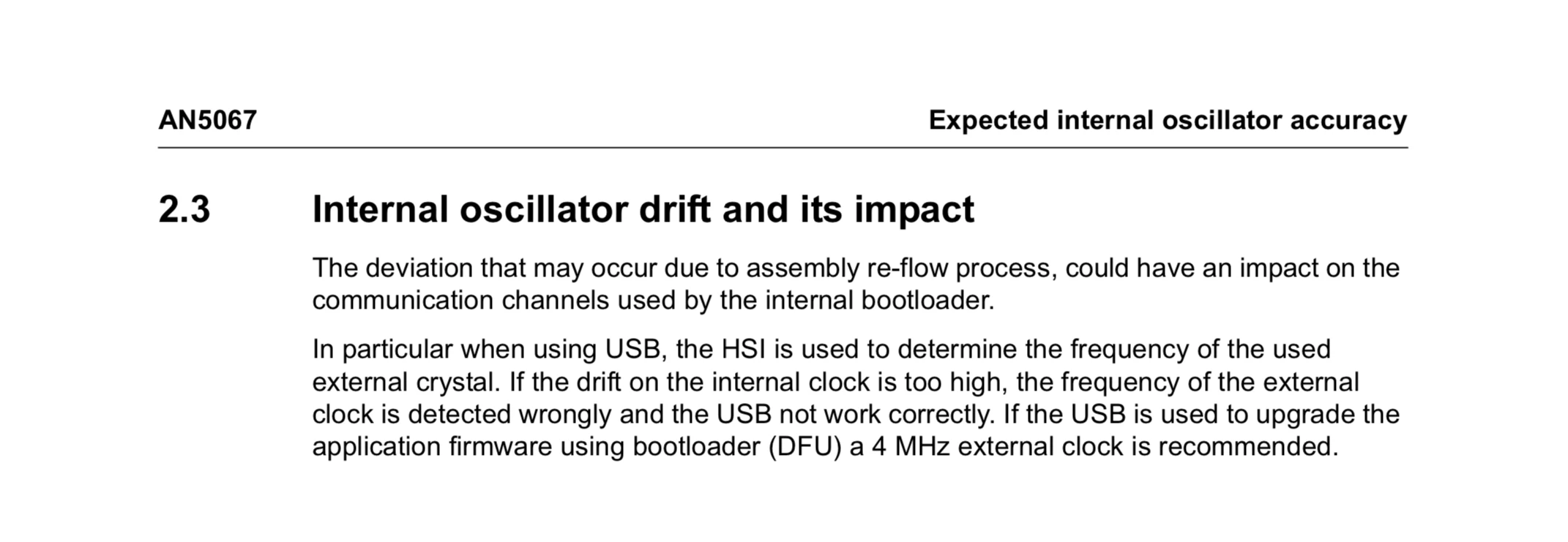

Dear @bymrz @Ugnas @Uwe Bonnes ,
This behavior is mainly due to a wrong Bootloader detection of the external crystal frequency for exemple detection =24Mhz where it is 25MHz and so baudrate of UART and USB using asynchronous clocking will be faulty.  This behavior is described here
https://www.st.com/resource/en/application_note/dm00425536-how-to-optimize-stm32-mcus-internal-rc-oscillator-accuracy-stmicroelectronics.pdf
to confirm this hypothesis, please try a crystal of 8MHz or 4MHz and let us know .
Hope it helps .

I found the issue...
It was BOOT1 pin left unconnected. I connected it directly to ground. DFU mode is stable now..
