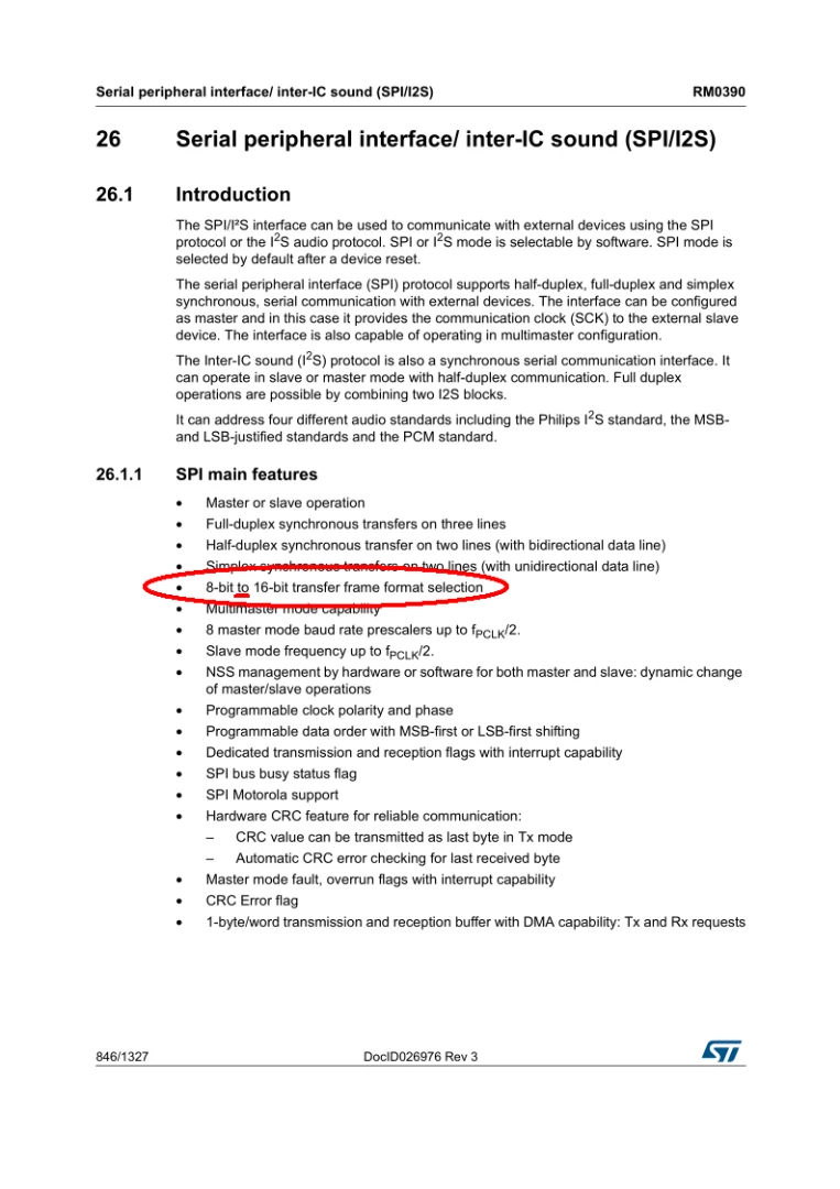

STM32F446 SPI transfer bit width
Posted on September 12, 2017 at 19:57
IMO, *to* is inappropriate here - as far as I can see, transfer width in 'F446's SPI can be only 8-bit *or* 16-bit.
    Imen.DBest answer
    Sep 13, 2017 3:54 PM UTC
    Posted on September 13, 2017 at 17:54
    Hi
    Waclawek.Jan
    Yes, I confirm this typo. It should be '8-bit or 16-bit'
    I will report this internally to correct it in the next release of reference manual.
    Thanks
    Imen
