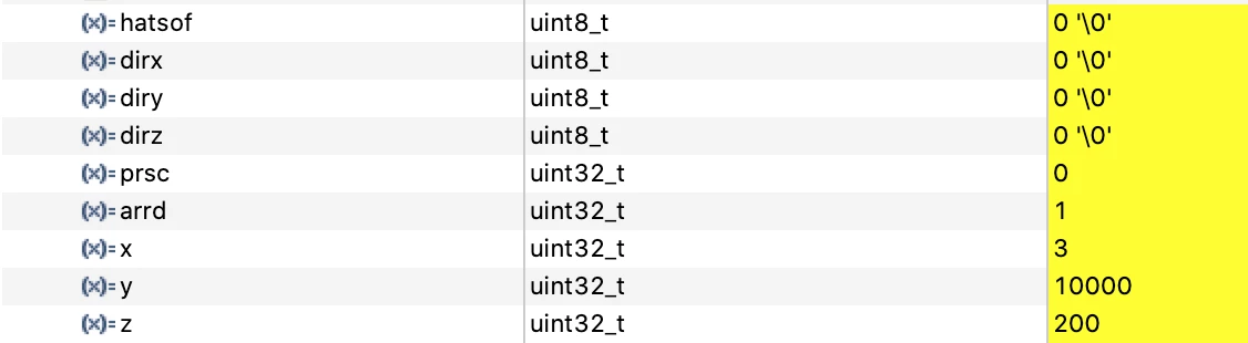

all this variables are in the first structure in the union. The first and second time I call the transforma2() function, the transformation from hex string to this values works. When I do it for the 3rd time, the information appears like this:
hatsof = 0
dirx = 0
diry = 0
dirz = 0
prescaler = 0
auto-reload = 10000
x= 200
y= 0
z= 0
The problem is really weird because if I debug the code step by step, it works just fine and there is no problem at all...but when I run it, the values got wrong...

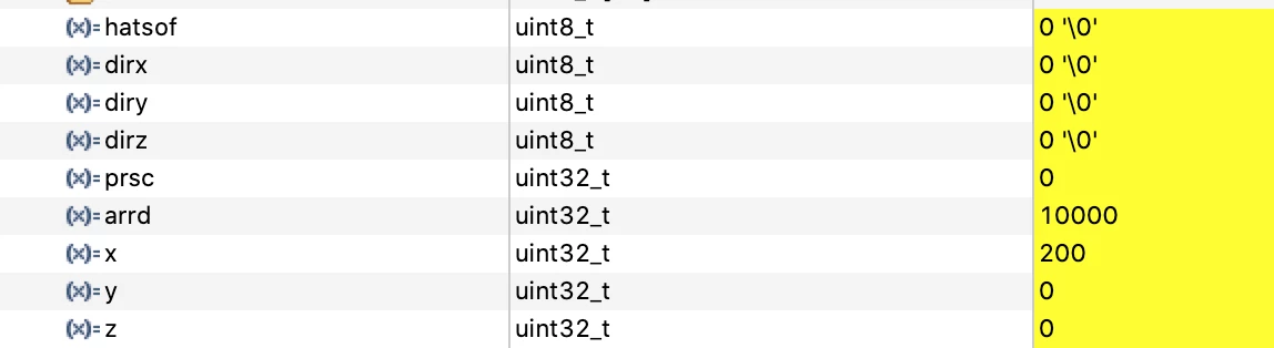

Here it is the capture of the 4th time I call the function:
what could be wrong?? I something about the architecture or about the registers I am configuring wrong???
