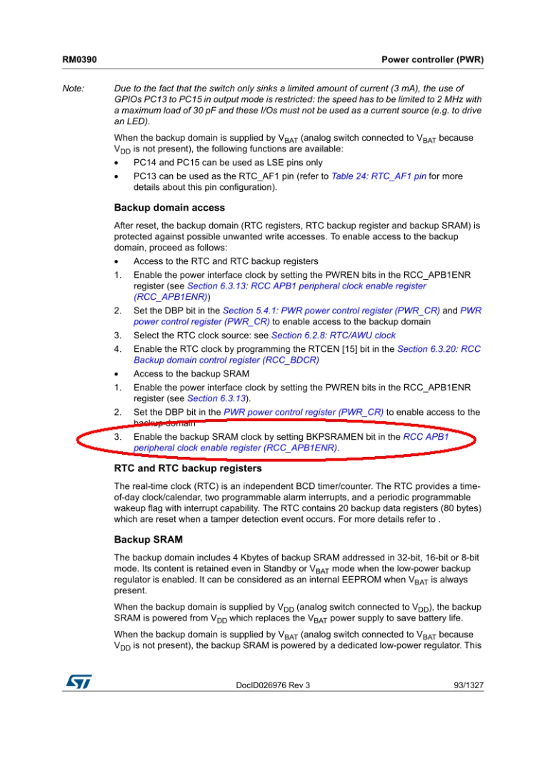

ADC is irrelevant.
Should be RCC AHB1 peripheral clock enable register (RCC_AHB1ENR).

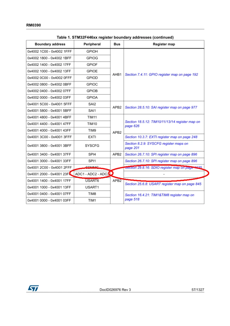

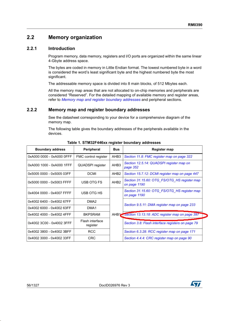

    Posted on September 12, 2017 at 21:16
    The ADC reference/link from the first picture I posted above should probably go here:
