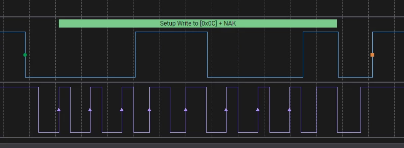

Here is logic analyzer's screenshot:

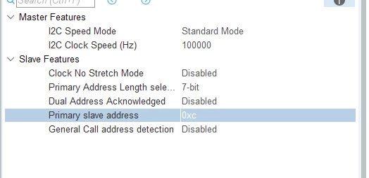

And here is F446 configuration on CubeMX
I don't get why is it sending NACK when address is correct.
When trying to do the opposite (F446->F103) it sometimes throws BERR error or same thing happens, NACK with correct address

The address octet shown in the diagram is 00011000. There are two conventions for specifying I2C addresses. ST HAL uses the one different from your logic analyzer. For ST, the address sent (and NACKed) is 0x18. You should probably set the slave address to 0x18 in CubeMX.

Autogenerated code by CubeMX already takes care of it:
static void MX_I2C1_Init(void)
 /* USER CODE BEGIN I2C1_Init 0 */
 /* USER CODE END I2C1_Init 0 */
 /* USER CODE BEGIN I2C1_Init 1 */
 /* USER CODE END I2C1_Init 1 */
 hi2c1.Instance = I2C1;
 hi2c1.Init.ClockSpeed = 100000;
 hi2c1.Init.DutyCycle = I2C_DUTYCYCLE_2;
 hi2c1.Init.OwnAddress1 = 24;
 hi2c1.Init.AddressingMode = I2C_ADDRESSINGMODE_7BIT;
 hi2c1.Init.DualAddressMode = I2C_DUALADDRESS_DISABLE;
 hi2c1.Init.OwnAddress2 = 0;
 hi2c1.Init.GeneralCallMode = I2C_GENERALCALL_DISABLE;
 hi2c1.Init.NoStretchMode = I2C_NOSTRETCH_DISABLE;
 if (HAL_I2C_Init(&hi2c1) != HAL_OK)
 Error_Handler();
 /* USER CODE BEGIN I2C1_Init 2 */
 /* USER CODE END I2C1_Init 2 */
When sending the address I am also sending 0xC<<1 which is equals to 24
