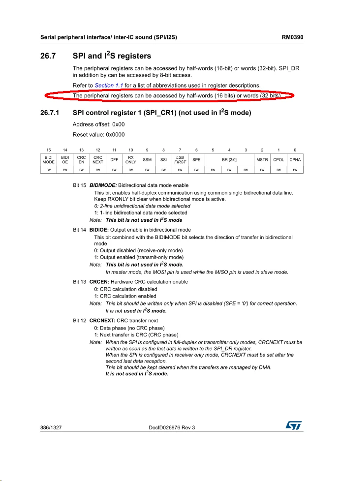

The highlighted sentence is a duplicate - see the other one above it. One of them is obviously incorrect - which one? - and shall be removed.

    Hi
    Waclawek.Jan
    Thanks for highlighting this typo.It is noted and will be fixed in next release of the document.
