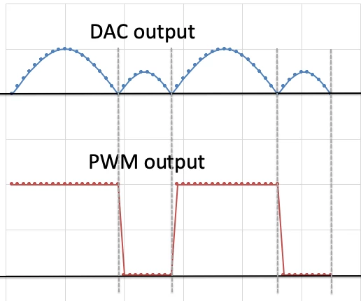

Hi all,
I need to generate a DAC output which is operating on 2 quadrants and the quadrants may be asymmetrical with respect to both the duty cycle and the amplitude. Attached a picture which better explains what I need.
MCU STM32F446RE
DAC OUT1 on pin PA4 - triggered by TIM6
DMA channel 1 stream 5
PWM out: TIM1 CH3 with output on pin PA10
frequency range: 10-500Hz (frequency of the DAC waveform)
The PWM output is controlling the polarity while the DAC is controlling the output amplitude. The polarity must be changed when the DAC output completes 1 cycle.
I need ideas on how to implement it. Since the DAC output is asymmetric I don't know how to create the LUT: should I create a complete LUT with both the quadrants or should I change the LUT array at the polarity change ?
In the first case I don't know how to trigger the PWM output in sync with the DAC waveform while, in the second case, I don't know if I have enough time to recalculate the LUT at the polarity change.
Another option I was thinking is to use a standard GPIO (on pin PA10) instead of the PWM, which I can toggle at the DAC zero crossing, but this will need to "ping-pong" between 2 different LUTs and I don't know how to do it.
Ay ideas on how to proceed ?
Thanks,
Max

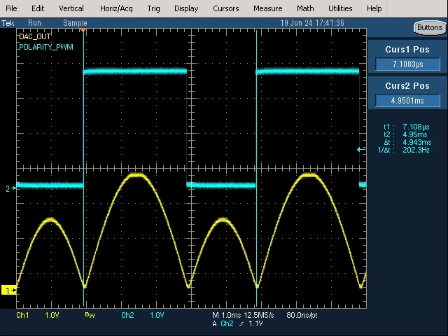

McMaxAuthor
June 19, 2024
and it works!
TIM1 is used as master with PWM output and TIM2 is used as slave to trigger the DAC. I had some issues at the beginning because I realize later on that TIM1 is attached to APB2 with double the clock with respect to TIM2 which is attached to APB1! I've then set APB2 with the same clock and TIM2_PSC = TIM1_PSC/#_LUT_points: by doing this I-m using the same value for ARR on both the timers and I'm good to go.
The frequency is adjustable from 10 to 500Hz and duty cycle from 20 to 95 %
Here attached an example at 200Hz with 60% DC.
Many thanks Jan for your great help!

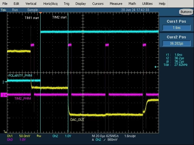

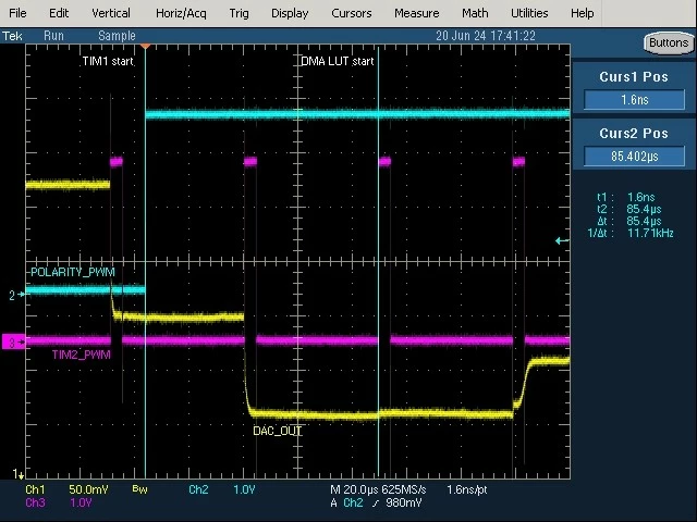

I noticed that, despite the 2 timers are synchronized, there is a delay of TIM2 (slave) with respect to TIM1 (master). Please have a look at the attached picture to better understand the issue.
I think we have 2 problems here:
- TIM2 is not perfectly synchronized with TIM1 - the minimum delay that I measure is around 36usec. This is acceptable for my application but I was expecting a better sync considering that the core is running at 180Mhz...
- The first point of the DMA LUT is delayed by about 85usec, and this is still acceptable but we are at the limit. Maybe here I'm messing up with something in the code and I'm asking your help in understand what this could be
I've tried to play with the master/slave mode option on both the timers (the one that is referring to delay the TRGO/TRGI) but nothing is changing in the waveforms. Also, it is not clear to me if this option needs to be enabled on the Master or on the Slave timer....
Overall I'm ok with the solution I've implemented but I want to understand if I do something wrong and how I can improve.
Thanks,
Max
the following picture is showing the delay between the polarity PWM period start (TIM1 - master) vs the DAC LUT period start (triggered by TIM2). TIM2_PWM has been activated only for measuring purposes.
this is showing the minimum delay between TIM1_PWM (master) and TIM2_PWM(slave)
