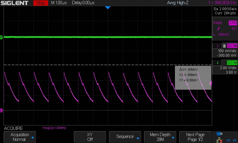

STM32F446 ADCs Fighting Inputs
Posted on March 09, 2017 at 16:59
I am using a single channel on ADC1, and a single channel on ADC2, both using DMA.  Everything code-wise is working, but the ADCs appear to be fighting/resisting the inputs.  For instance, with nothing connected, each ADC pin floats at ~1V.  But then when you try to ground either input through a 10K resistor, I get a ~250mV triangle wave at 1MHz.  Image is attached below, along with CUBE generated ADC initialization code.  Any ideas on what could be causing that?  I would think that grounding an ADC input through a 10K would cause the input to go to zero.

    If looking at a single channel per ADC, why use scan mode?
    hadc1.Init.ScanConvMode = ENABLE;
    What happens if the sample and hold time is increased? (because the input impedence is not low)
    Otherwise, for testing pull-up/down, the internal GPIO ones can be used instead of an external physical one?
    Are VDDA/VSSA well connected to board common ground/supply?

    YOU...are awesome.  I had been using scan mode initially, and that was left enabled.  I switched it to DISABLE, and all is well.  Thanks for the help!
