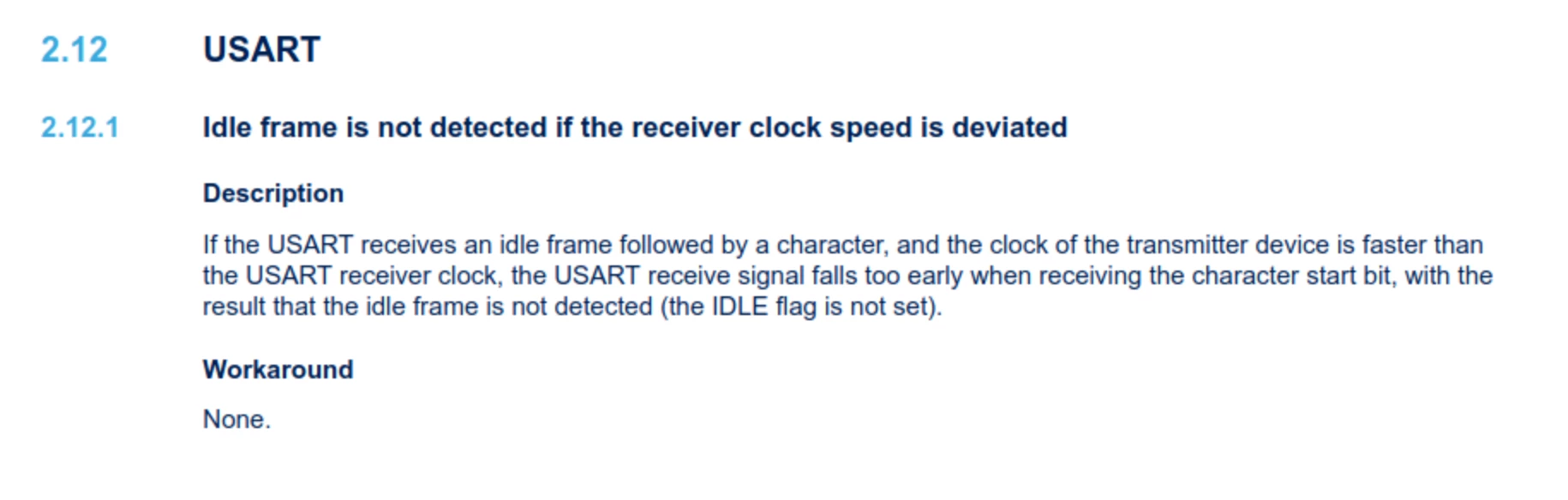

I found in the errara sheet this entry:
Is this somehow related?
Thank you.

Finally found the problem. In the HAL config file, there is an entry:
#if !defined (HSE_VALUE)
 #define HSE_VALUE 24000000U /*!< Value of the External oscillator in Hz */
#endif /* HSE_VALUE */
This value was set to 25MHz (default value). With 24MHz, it works.
October 9, 2023
> Even the UART reports this noise/frame errors, the message is sampled correctly, the byte has the right value.
UART oversamples each bit. If only one of those samples is off, a noise error is generated even though the bit will be correct. The reference manual goes into detail about this.
