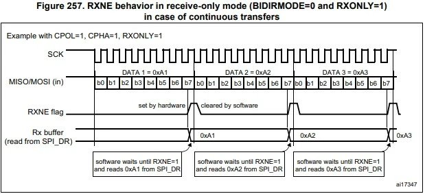

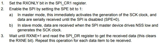

Referring to the RM0090 Manual programming SPI Receive.

/* Enable SPI, SPE = 1 */
SPI1->CR1 |= 0x0040;
/* Check RXNE flag */

According to Figure 257 in RM0090, RXNE should only be raised after the SPI_DR register has received data completely.
I infer that the RXNE bit is to 1 when the SPI_DR register has data, causing the program to execute the CS set HIGH after checking RXNE, which evidently differs from the actual behavior.
