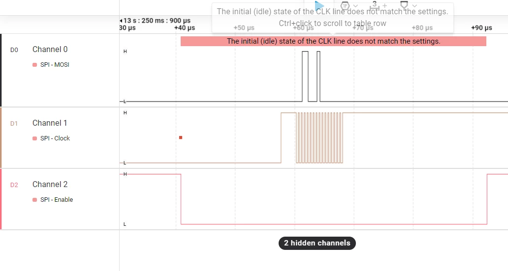

I generated code using CubeMX that should permit me to transmit over SPI1 using DMA for RX and TX, as well as CPOL = 1 and CPHA = 1. I very slightly modified the auto generated CubeMX code but see nothing in the SPI CR1 or CR2 registers, nor the DMA2 registers, that would indicate I have made a configuration mistake when modifying the code slightly. My init functions are here:

My transmission is all warped. The SCL is generated wrong (it does not start from a high state, and I have CPOL = 1, and there are not enough pulses for 16 bits) and the NSS pin seems to deassert for some reason:

A few things happening here:
  • SCL will be low before the pin is initialized and the peripheral is enabled. Once initialized/enabled, it goes high. Sending a dummy transfer of 1 byte (with CS high) will enable it, among other ways.
  • Your logic analyzer sampling rate is too slow to see all 16 clocks.
  • Not sure why the NSS pin goes high, perhaps noise, but it's best to control this pin manually. The peripheral will set it low and keep it low--not very useful. Better to make it a GPIO pin, set low before transaction and high afterwards.

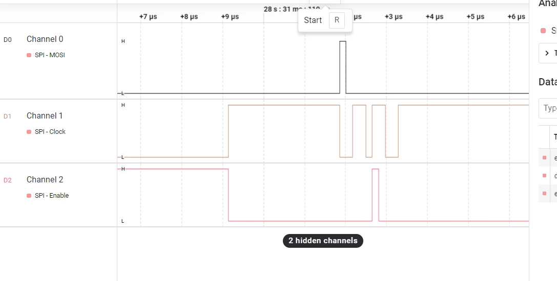

I reconfigured the GPIO pin that was previously being used as the NSS pin as a GPIO output, and set the pin LOW when the call to transmit begins. I ensure that the GPIO pin now being used does not go high until the DMA transfer complete callback executes as I have transfer complete interrupts enabled. I mediate this through the use of a binary semaphore which is taken before the call to transmit, and is released once the transfer completes in the ISR like so:

You can see in the attached capture the general logic with de-asserting/asserting the CS pin works, albeit there is some additional delay between the assert/deassert and the completion of the transfer due to HAL library calls eating up a 10-20 microseconds which messes with the analyzer:

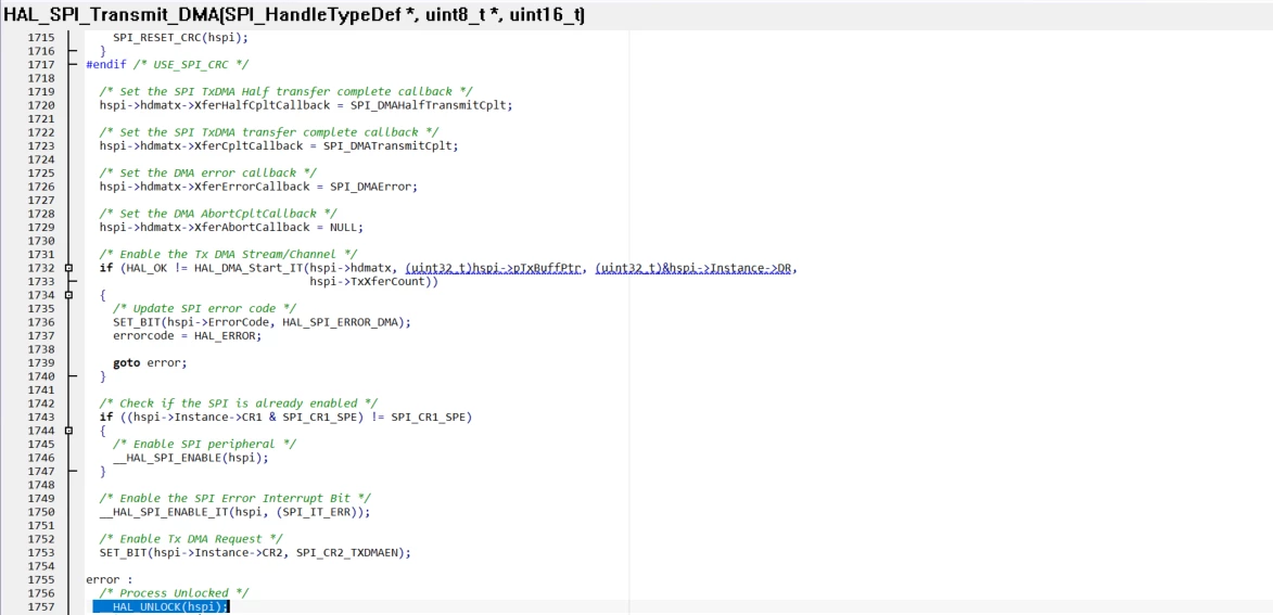

However, for some reason now the call to HAL_SPI_Transmit_DMA hangs indefinitely when the SPI handle typedef used to initialize SPI1, the peripheral in use, is unlocked at the end of the function call. I have highlighted here where this occurs. The errorcode is 0x00 (HAL_OK) when debugging:
