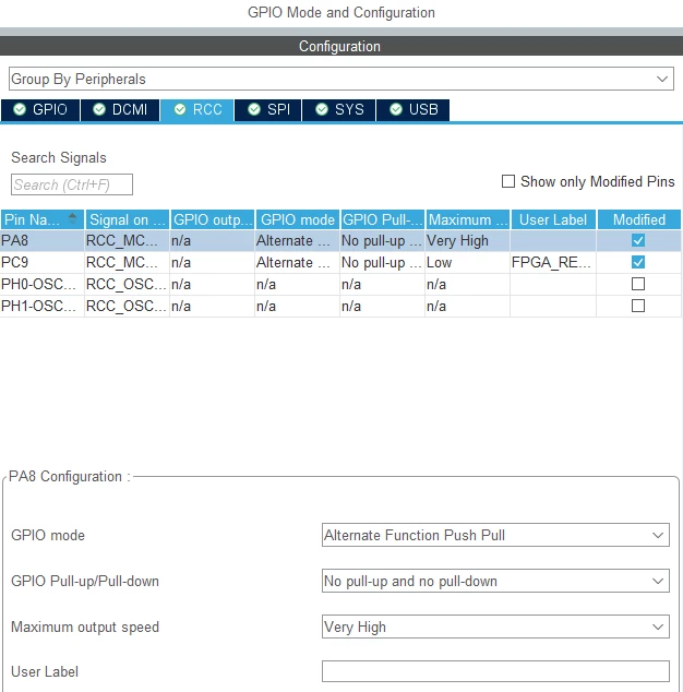

    MKing
    January 17, 2024
    I had the same problem. The reset waited as well for the reset of the external PHY USB3310. So I had to disable the RESET pin before USB init is done:
    #define USB_RESET_On HAL_GPIO_WritePin(USB_RESET_GPIO_Port, USB_RESET_Pin, GPIO_PIN_RESET)
    #define USB_RESET_Off HAL_GPIO_WritePin(USB_RESET_GPIO_Port, USB_RESET_Pin, GPIO_PIN_SET)
    void MX_USB_DEVICE_Init(void)
     /* USER CODE BEGIN USB_DEVICE_Init_PreTreatment */
    	 USB_RESET_Off;
    The second problem was that the USB_REFCLK was missing. When i created the project by CubeMX the "Maximum output speed" is "Low" bit in my case I have 24Mhz so I set it to "Very High".
