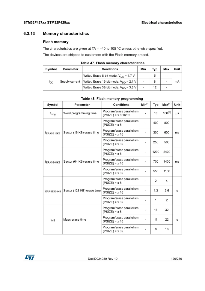

How to calculate Flash memory write time?

(erase_time_per_sector * number_of_erased_sectors) + (programming_time_per_PSIZE * number_of_PSIZE_programmed)
