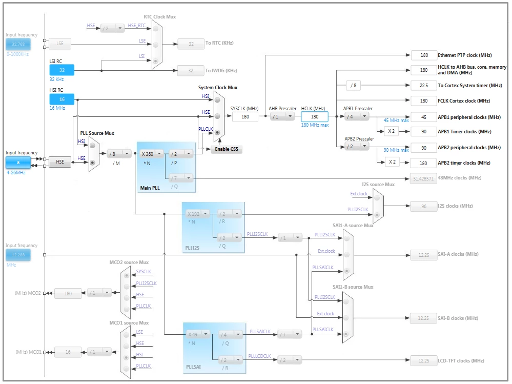

Its my first time here! I have a STM32F429I-DISCO, original from factory. I used the STM32CubeMX with STM32Cube_FW_F4_V1.3.0 to build a code. I selected ''new project\board selector\Type of Board: Discovery\Series: STM32F4\Board List: STM32F429iDISCOVERY'' In the Clock Configurations, all items seemed OK. If I properly understood the manual, the HSE is used for external xtal. In this kit, this crystal is the X3... A 8MHz xtal.
I put a screenshot of
STM32CubeMX
here. I built a very simple code to the first test of my kit.
/* USER CODE BEGIN 3 */
BSP_LED_Init(LED3);
/* Infinite loop */
while (1)
__asm(
''ldr r1, =0x40021800;''
''ldr r3, [r1,#20];''
''loop:;''
''eors r3, 0x2000;''
''str r3, [r1,#20];''
''b loop;''
/* USER CODE END 3 */
This code will switch the output port PG13, referring to LED3. I could see a waveform with these following time base: ____ _... ..._| |____| +---50nS--+ Until this point everything seemed OK. However, when I pulled the X3 crystal, to my surprise, the kit remained operational!!! I can not understand how this is possible!!! Would you could help me with this? Now, I'm not even sure if the kit is running at the correct frequency of 180MHz!!!

    I know that the STM32F429ZIT microcontroller, does not need an external crystal to work, however I setup the STM32CubeMX tools, for it generate a code using the Crystal Factory X3 8MHz.
    You saw the screenshot that I put in the topic?
    You can check that the code was configured to use this crystal by the HSE.
    There was not any error after the compilation!
    I have not found SystemInit()
    Follows below the initialization routine of the system clock:
    void SystemClock_Config(void)
    RCC_OscInitTypeDef RCC_OscInitStruct;
    RCC_ClkInitTypeDef RCC_ClkInitStruct;
    __PWR_CLK_ENABLE();
    __HAL_PWR_VOLTAGESCALING_CONFIG(PWR_REGULATOR_VOLTAGE_SCALE1);
    RCC_OscInitStruct.OscillatorType = RCC_OSCILLATORTYPE_HSE;
    RCC_OscInitStruct.HSEState = RCC_HSE_ON;
    RCC_OscInitStruct.PLL.PLLSource = RCC_PLLSOURCE_HSE;
    RCC_OscInitStruct.PLL.PLLM = 8;
    RCC_OscInitStruct.PLL.PLLN = 360;
    RCC_OscInitStruct.PLL.PLLP = RCC_PLLP_DIV2;
    RCC_OscInitStruct.PLL.PLLQ = 7;
    HAL_RCC_OscConfig(&RCC_OscInitStruct);
    HAL_PWREx_ActivateOverDrive();
    RCC_ClkInitStruct.ClockType = RCC_CLOCKTYPE_SYSCLK|
    RCC_CLOCKTYPE_PCLK1|
    RCC_CLOCKTYPE_PCLK2;
    RCC_ClkInitStruct.APB1CLKDivider = RCC_HCLK_DIV4;
    RCC_ClkInitStruct.APB2CLKDivider = RCC_HCLK_DIV2;
    HAL_RCC_ClockConfig(&RCC_ClkInitStruct, FLASH_LATENCY_5);
    I'm not sure if you understood my problem...
    I configured the application supplied by ST, to generate one code for this kit.
    To the microcontroller use the crystal, that the manufacturer place in this kit, and did not work this way.
    The program STM32CubeMX generated all the code and I did not modified anything! Why not worked as expected?!

    I'm not sure if I made the right way, but...
    I
    performed in debug mode and after that went through
    I captured the following variables:
           Details:{OscillatorType = 1,
                    HSEState = 1,
                    LSEState = 0,
                    HSIState = 8192,
                    HSICalibrationValue = 4294967289,
                    LSIState = 1073879040,
                    PLL = {PLLState = 2,
                           PLLSource = 4194304,
                           PLLM = 6,
                           PLLN = 300,
                           PLLP = 2,
                           PLLQ = 8}}
    Is that what you need?
    I
    f I did something wrong, please tell me what I have to do and how!
