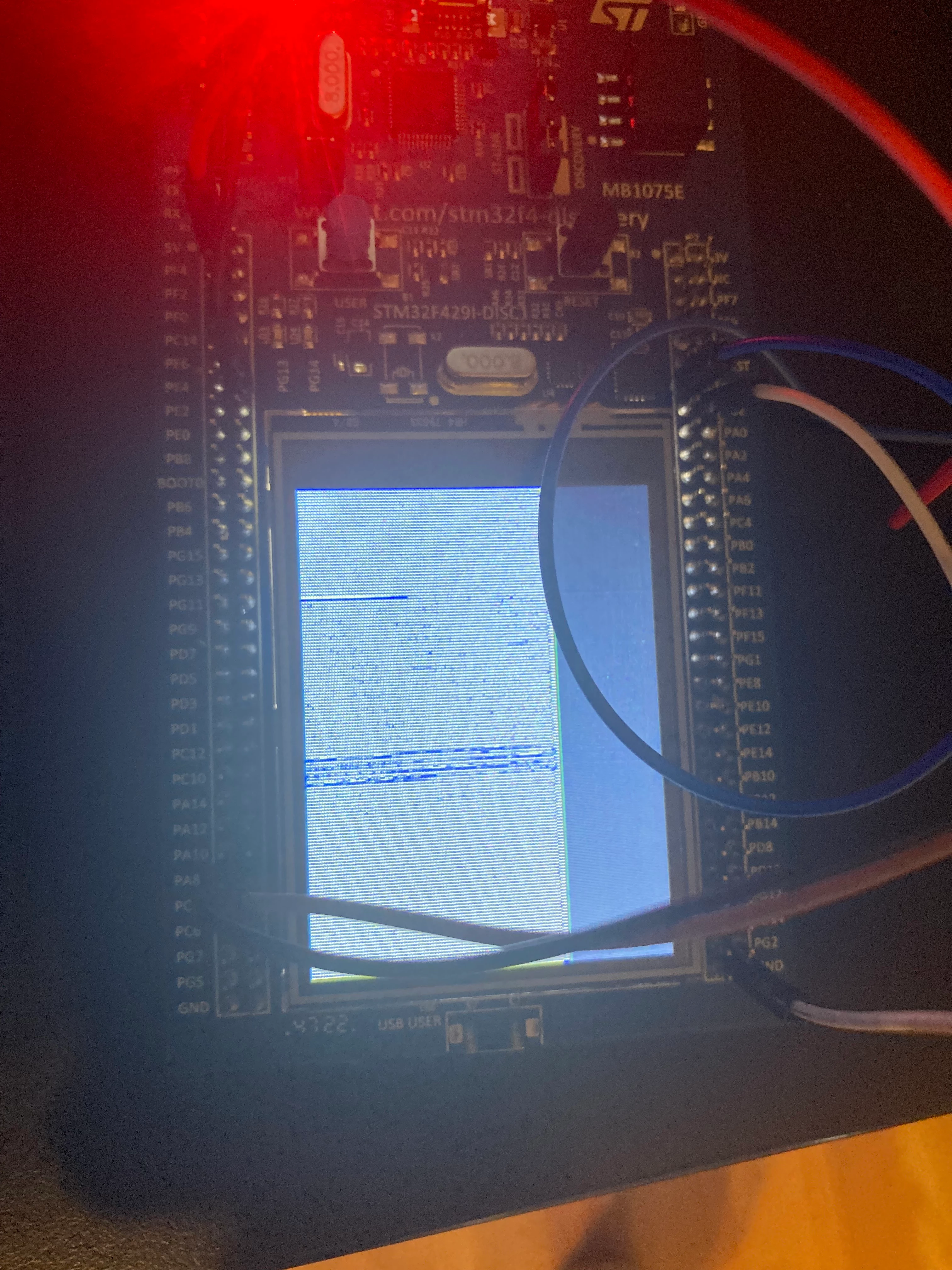

Hello, I'm working on a project on the STM32F429I-Disc1 development board and wanted to use the BSP to write characters to the LCD screen. I used STM32CubeMX to configure with LTDC enabled with the default parameters. Since there wasn't BSP configuration I added the files manually for the LCD BSP which were:
src:
  • font12.c
  • font16.c
  • font20.c
  • font24.c
  • font8.c
  • ili9341.c
  • stm32f429i_discovery_lcd.c
  • stm32f429i_discovery_sdram.c
  • stm32f429i_discovery.c
inc:
  • fonts.h
  • ili9341.h
  • lcd.h
  • stm32f429i_discovery_lcd.h
  • stm32f429i_discovery_sdram.h
  • stm32f429i_discovery.h
I updated the BSP init function to match the LTDC settings for the board:
LtdcHandler.Init.AccumulatedActiveW = 269;
LtdcHandler.Init.AccumulatedActiveH = 323;
LtdcHandler.Init.TotalWidth = 279;
LtdcHandler.Init.TotalHeigh = 327;
When I run the BSP_LCD_Init function it returns status OK, but after running this line:
LcdDrv = &ili9341_drv; and eventually these three lines in ili9341_Init(void)
ili9341_WriteReg(LCD_SLEEP_OUT);
LCD_Delay(200);
ili9341_WriteReg(LCD_DISPLAY_ON);
/* GRAM start writing */
ili9341_WriteReg(LCD_GRAM);
The screen does this (see attached photo) where it flickers and has this black box on the right side.
I didn't want to change the driver files for the ili9341 so I am assuming something is wrong with my configuration but I wasn't sure how to further troubleshoot this. Does anyone have advice or see any issues of what may be happening?

I have RevE as my board version and set that in my preprocessor options (USE_STM32F429I_DISCOVERY_REVE). I followed the steps as in your example and still get no errors but the screen is not displaying properly, and the behavior is still taking place after the BSP_LCD_Init call mentioned in the original post. I'll take a deeper look this weekend, please let me know if you see any other issues with my setup!

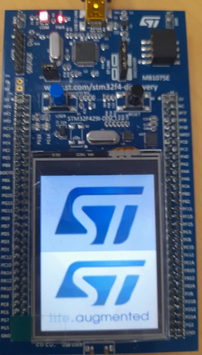

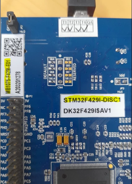

Hello @jake11212 ,
I tested the BSP and the LTDC_Display_2Layers examples with STM32F429I_DISC1 REV-E01 and I'm able to run these examples without issue as shown in the below figure:
May be your LCD is damaged.
Do you get "Error_Handler();" in HAL_LTDC_Init?
Thank you.
