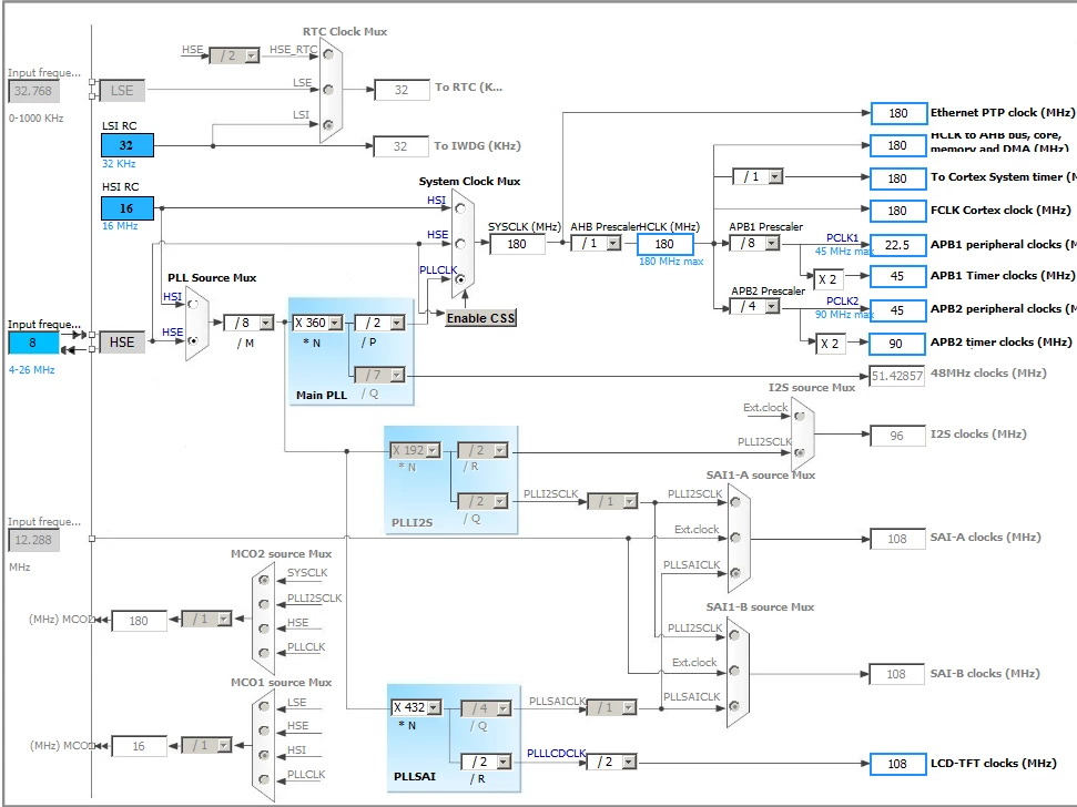

Given this, I suppose that the problem is related to Clock setting.
I have looked at Board's Reference manual, on page 18:
OSC clock supply
The following information indicates all configurations for clock supply selection.
� MCO from ST-LINK (from MCO of the STM32F429ZIT6)
This frequency cannot be changed, it is fixed at 8 MHz and connected to PH0-OSC_IN
of the STM32F429ZIT6. The configuration needed is:
� SB18 closed, SB19 open, R56 removed
� SB20, R57, C20, C21, X3 = do not care
This seems to be an initial setting, as shipped from factory (but R56 was in place)
� Oscillator on board (from X3 crystal)
For typical frequencies and its capacitors and resistors, refer to the STM32F429ZIT6
datasheet. The configuration needed is:
� SB18, SB19, SB20 open
� R56, R57, C20, C21, X3 soldered
This seemed likely as an answer to the question, so SB18 has been removed.
It did not help, the board does not start from external power source, but program runs when StLink is plugged (nothing changed).
I have such clock settings (8Mhz at input runs to HSE, PLLCLK is used for SysClock):

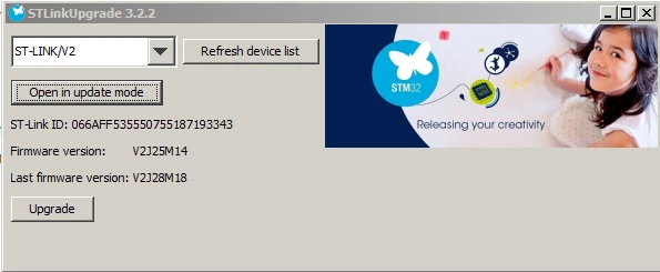

Powered the DISCO/NUCLEO with USB Chargers/Batteries here. There was a quirky build of ST-LINK firmware that would hold target in reset, but current firmware doesn't do that.

I have checked forum somewhat more deep, and found that the common advice here is to use this software. (Not sure what it does...)
https://my.st.com/content/my_st_com/en/products/embedded-software/development-tool-software/stsw-link007.html
I don't have any more ideas (removing resistors from board is too risky for me), so here it goes:
