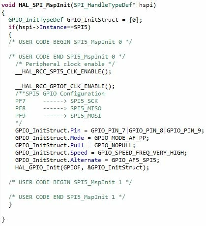

Today, I am trying to use SPI communication on my board. I saw that there is a gyroscope on my board. So, I thought it's a good idea to use this device as an example. Since it's already routed it up, I cannot mess up with connections, etc.
Here is the thing, I don't want to install additional libraries. Instead, I want to create/program this example via what everybody starts with. I use CubeIDE. CubeIDE already gives me a bunch of predefined functions with HAL and I assume that function is more than enough to complete this project.

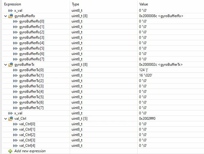

I guess I am able to use SPI since the function returns HAL_OK. However, I cannot read any value from either x, y, or z.

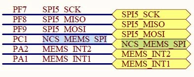

These are the pins according to the datasheet.
This is an SPI configuration made by Cube automatically. I didn't change anything from here.
I upload the program in case someone wants to look at it.

I use SPI but, I'm guessing Majerle doesn't have the SPI_Receive function in DATA_Read.
anyway, that info is a little irrelevant.
I want to learn from my mistakes and get better at this stuff.
THANKS for your attention,
Kind Regards.
*I set pin A1 for interrupt, but I didn't use it for interrupt. Is that the problem? If it's the case then, that might be a very rookie mistake.:grimacing_face:
