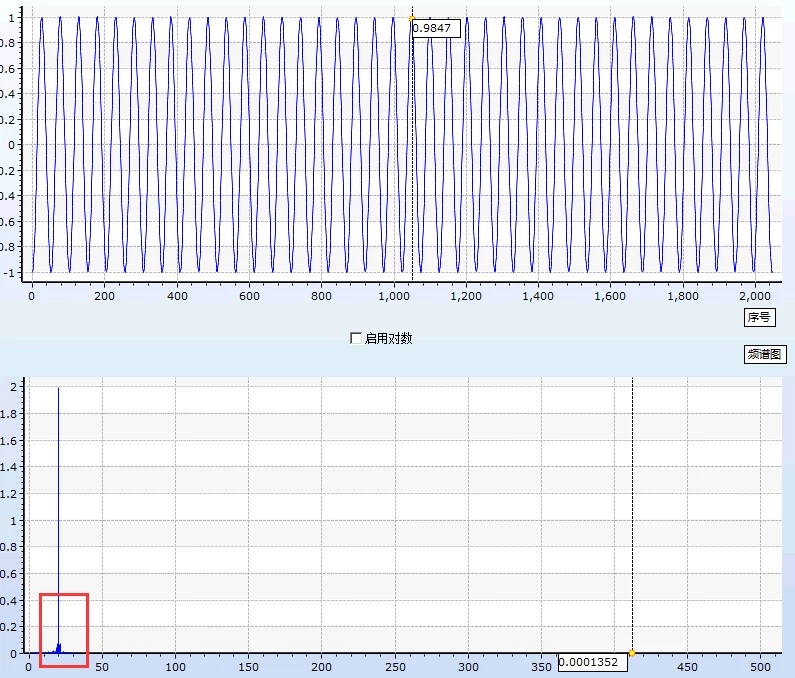

stm32f429 timer pwm output signal as a clock
Posted on July 06, 2017 at 05:53
I am working with the STM32F429 and we use the timer pwm output as the ads1271 CLK。 we get the wave as the picture show
We think CLK
quality
 is poor,so the sample rate is inaccurate. Any ideas ?
Thanks,
End.

    The main reason is my SPI interrupt function that recieve data from ADS1271  is inefficient. SPI lost samle points, after improve the spi ISR performance,now 4 x 102.4KSPS worked well for me.

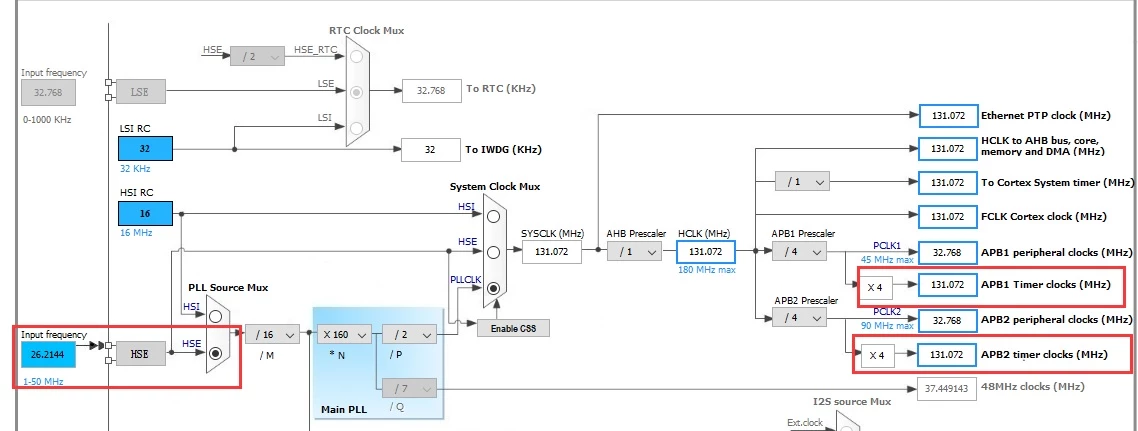

    are you running your F429 with HSI or HSE?
    liu yong
    liu yongAuthor
    Jul 6, 2017 7:34 AM UTC
    Posted on July 06, 2017 at 07:34
    follow is the clock config
    waclawek.jan
    Jul 6, 2017 9:59 AM UTC
    Posted on July 06, 2017 at 09:59
    Review PLL parameters (jitter) in DS and compare to your requirements/measurement.
