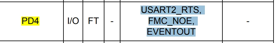

I'm sorry reply so late. I wonder can PD4 associate with a PWM output?I just see PD4 alternate function as:
