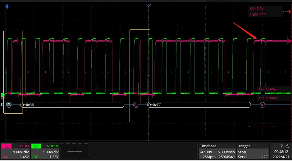

STM32F429's I2C cannot send data after calling HAL_I2C_Master_Transmit_DMA, Then both the SDA and SCL switch high level to low? it always return HAL_I2C_STATE_BUSY_TX.
