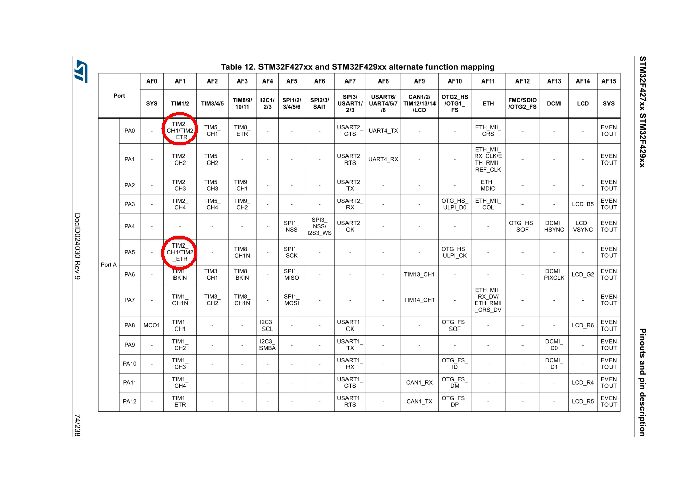

You can't assign functions to pins randomly. PG11 does not connect to TIM2_CH1 - for that you'd need PA0, PA5 or PA15. Look at the table in the STM32F429's datasheet:
etc.
GPIOG ->AFR[1] |= GPIO_AF1_TIM2;
This is probably wrong too. I don't know where do you have GPIO_AF1_TIM2 from, but most likely it's value is 1 and you'd need to shift it to left to match the pin's respective position in AFR[].
HAL_TIM_PWM_Start;
This is almost certainly not what you wanted. If you want to call a function, you must add the brackets, HAL_TIM_PWM_Start().

Thank you so much! I made the suggested changes. I had already found my mistake in taking pin G-11 and had replaced it with pin A5 already but all other suggestions helped a lot. The code is working fine now and I am getting desired output. For anyone who is having this problem, here is my updated code
