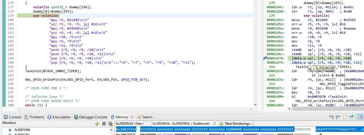

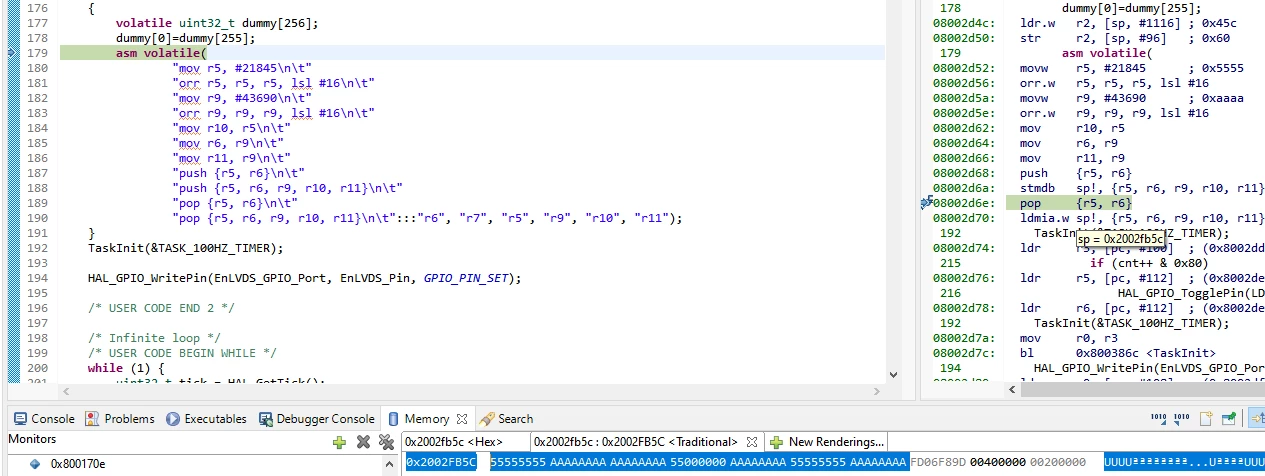

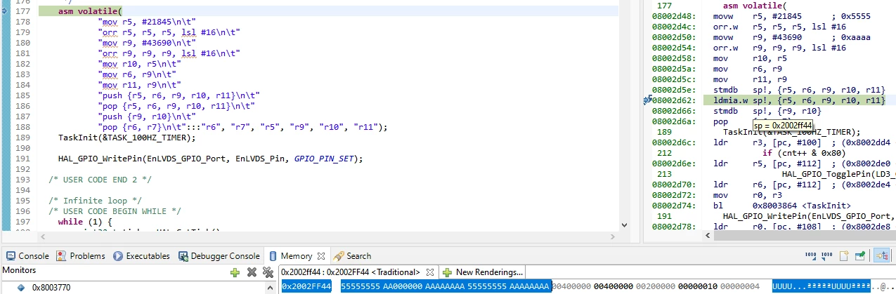

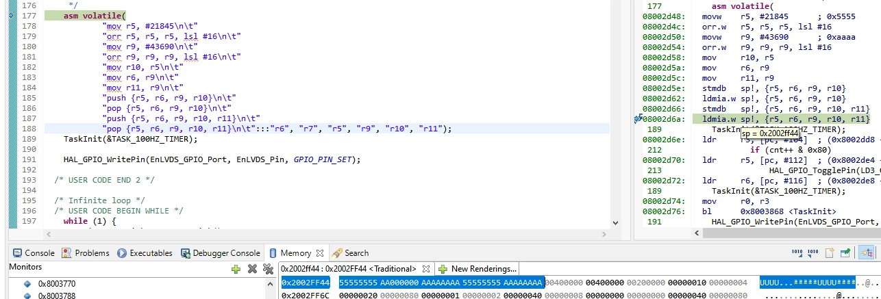

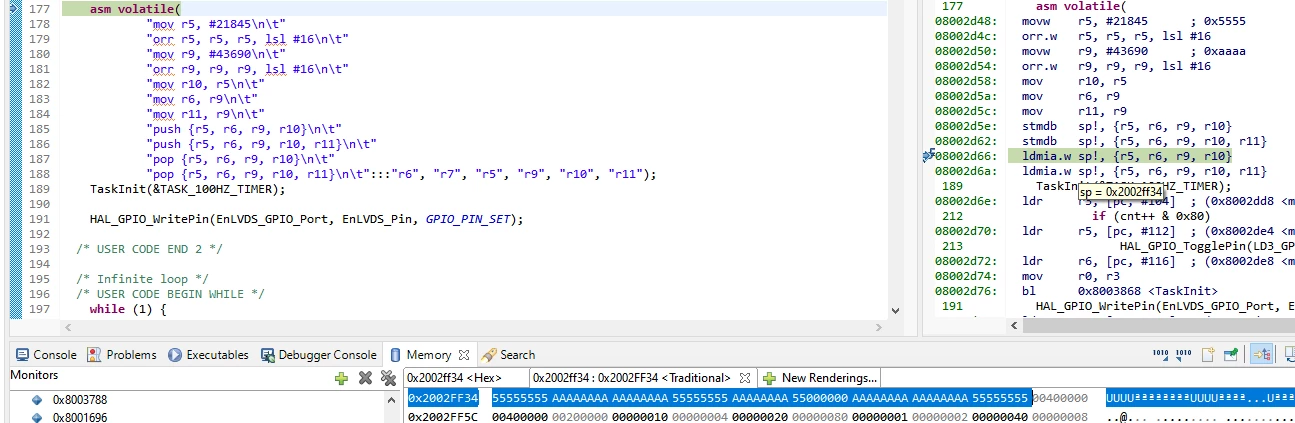

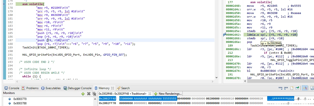

In order to investigate further, I added some inline assembler just before the function call pushing some registers to the stack and popping them back.
  5. Push 4 - Push 5 - Pop 4 - Pop 5 at other stack position0693W00000DpmJyQAJ.png
  6. Push 2 - Push 5 - Pop 2 - Pop 5 at other stack position0693W00000DpmROQAZ.png
To summarize:
Whenever I push to a specific, relative (to an unknown reference) stack position, only the least significant byte is written. This is independet on the number of push instructions needed to reach this stack position, the number of registers written with this instruction or the absolute stack position in memory.
Has anybody seen this behaviour before? Or does anybody have an idea, what could be the underlying problem here?

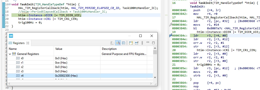

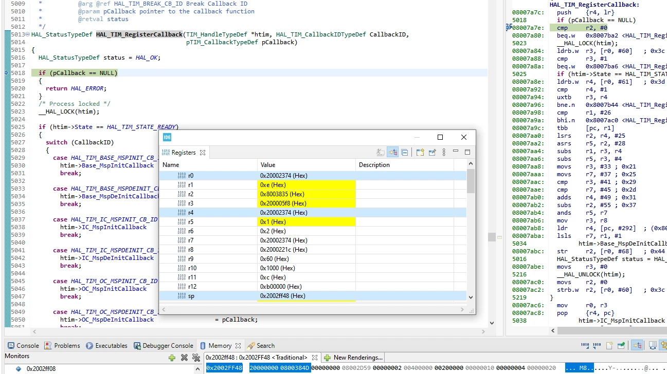

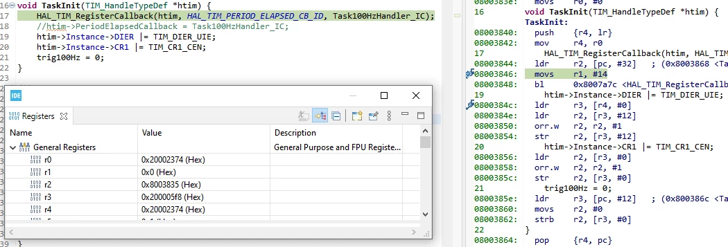

From main(), I call TaskInit() which in turn calls HAL_TIM_RegisterCallbacks. Both functions take a pointer to TIM_HandleTypeDef as parameter. In my case, this is htim7 at 0x20002374.
First, I stopped in TaskInit() right before the branch to HAL_TIM_RegisterCallback.
0693W00000DpnYfQAJ.pngAs you can see, both r0 and r4 contain the correct address for htim7.
In the next turn, we stop just after the HAL_TIM_RegisterCallback() is branched to.
0693W00000Dpna7QAB.pngAs you can see, in HAL_TIM_RegisterCallback(), r4 and lr are pushed onto the stack. Unfortunately, the value stored to the stack for r4 is wrong.
Again, next turn, stopping just after the HAL_TIM_RegisterCallback has popped the stacked values and returns to TaskInit().
0693W00000DpnbtQAB.pngAs you can see, r4 doesn't point to htim7 anymore and my program hard faults (or does other things I don't want it to do...).
If I would have stepped through the instructions after the first breakpoint, everything would have worked as expected. But if I restart the program and disable the previous breakpoint(s), this is the result.
