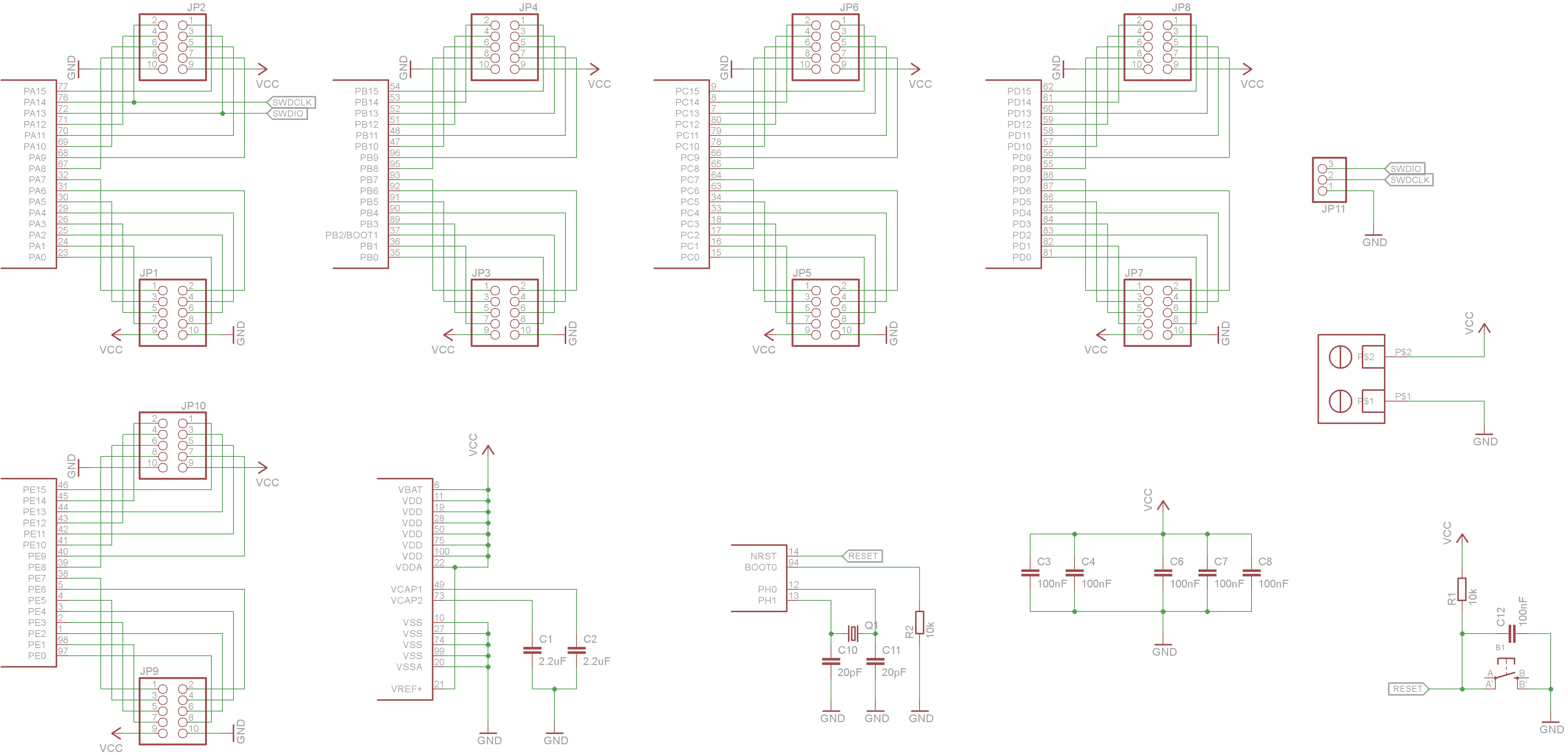

Hello!
I'd like to design minimal schematic for STM32F429. I'd like to have all pins connected to goldpins. I want to program through ST-LINK and SWD. Please check my schematic. It's in the attachment.
Thanks!
#stm32f429 #basic-circuit

I'd definitely recommend getting NRST to the debug connector, and would strongly suggest providing a standard connector (10-pin SWD or 20-pin JTAG)
Also consider a jumper option for BOOT0, and the ability to power VBAT independently.
