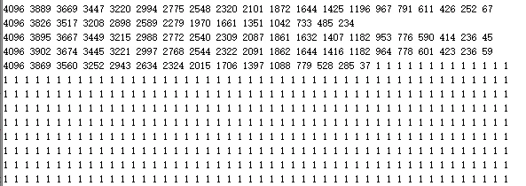

However, the SPI5 DMA function is not functioning properly.
// __HAL_LTDC_DISABLE_IT(&hltdc, LTDC_IT_LI);
HAL_SPI_Receive_DMA(&hspi5,pBuffer,NumByteToRead);
while(__HAL_DMA_GET_COUNTER(&hdma_spi5_rx)!=0)
printf("%d ",__HAL_DMA_GET_COUNTER(&hdma_spi5_rx));
printf("\r\n");
HAL_SPI_DMAStop(&hspi5);
// __HAL_LTDC_ENABLE_IT(&hltdc, LTDC_IT_LI);
The priority of SPI DMA is very high, while the priority of LTDC_IT_LI is very low.DMA waiting for the completion of the last data transmission all the time.If I remove the comments and disable the LTDC_IT_LI interrupt during SPI DMA, the SPI DMA will function normally.I suspect that it might be due to the limited bandwidth of the SDRAM that has caused the DMA error.I reduced the screen refresh rate to 10Hz but it still didn't work properly.I'm wondering what exactly is causing the spi dma exception when LTDC_IT_LI is activated.I don't want to temporarily disable the LTDC_IT_LI interrupt. What should I do?
