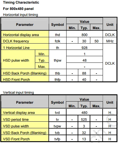

We are using Tianma’s - TM070RVHG01 TFT in our design with STM32F429 processor working at  168 MHz frequency. We are using EmWin Library on RTX operating system with LTDC support. We are statically storing the required ARGB format in external SDRAM. The data is loaded from SDRAM to LTDC (STM32F4 LCD Controller) using DMA2D and FMC interface (Flexible Memory Controller – Working at 168/2 MHz).
The colour configuration is ARGB8888  and driver configuration of EmWin is GUI_LIN_32.
From datasheet we understand that minimum DCLK is 28 MHz. So we are setting the DCLK as 28 MHz and calculated the parameters for LTDC which are as follows.
From Datasheet
HSYNC Width
20
VSYNC Width
3
HBP
46
VBP
23
Active Width
800
Active Height
480
BVBP
23
HFP
210
VFP
22
Calculated Value for LTDC Register
HSW
19
VSH
2
AHBP
65
AVBP
25
AAW
865
AAH
505
TOTAL W
1075
TOTAL H
527
Issue :
  1. We are find Tearing Effect in the display and the same time if we probe we could find FIFO underrun issue. Please let us know the above setting as correct for 28 MHz DCLK.
  2. When we reduce the DCLK to 24 MHz the display is stable but we are facing flicker issue.
Is there any solution for the above problems without using multi buffer support. Also could you send  sample source running on any RTOS for reference

    800*480*60=23Mgz

    I'm facing the same problem with below information
    • STM32H7 MCU platform
    • Embedded wizard for GUI development, LTDC support of course
    • TFT LCD with DCLK (26.4 MHz min, 33.3 MHz Typ., 46.8 MHz max)
    • System clock configuration: 400MHz
    • SDRAM clock configuration: 100MHz
    Tearing effect in TFT LCD also occur.
    I'm very appreciate if you help me to solve it

    So what rate are you clocking the display?
    How wide is you SDRAM interface?
    Understand H7 quite a different beast that F429I.​
    Francessco
    Visitor II
    Mar 18, 2019 9:02 AM UTC
    ==> 33MHz.
    ==> 32 bit
    For more information, I already config Pixel clock and timings configuration as TFT LCD specification but it does not work.
