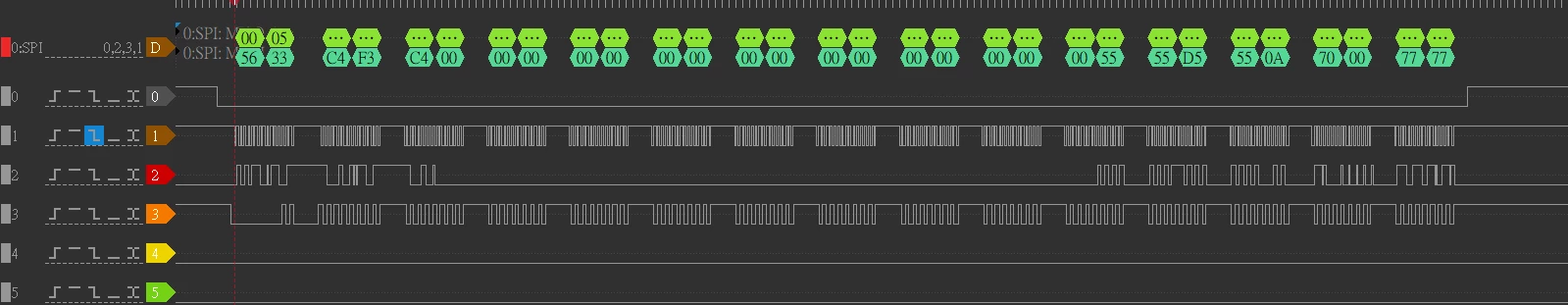

I use SPI with DMA , but the MOSI will shift randomly.

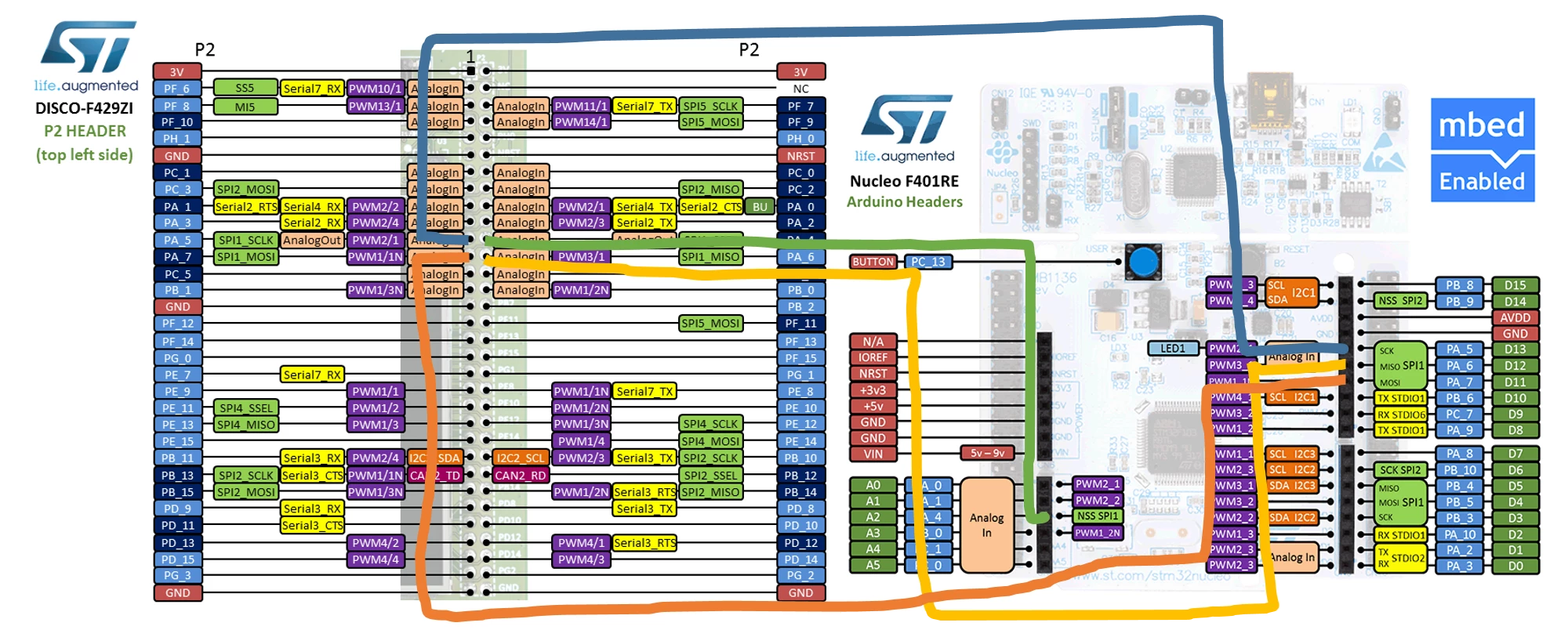

Connection of two boards.

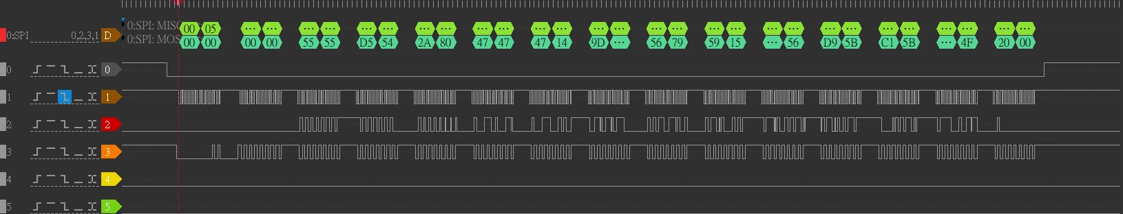

Random capture by logic analyzer
0690X00000AqTO6QAN.png0690X00000AqTO7QAN.pngI try the setting in Slave by change the configuration hard chip select and soft chip select, and the situation is the same.

> GPIO_InitStruct.GPIO_Speed = GPIO_Speed_100MHz;
Use lower OSPEEDR setting, shorter interconnection, twist the SCK with a ground wire.

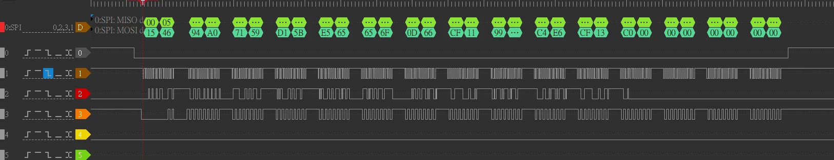

I try to twist the SCK with a ground wire, it can success communication in soft chip select.
But when I change the setting the MISO also shift in hard chip select.
