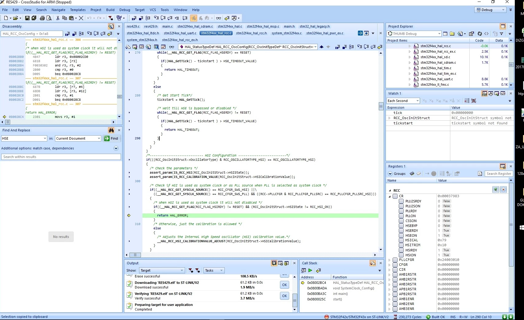

I am trying to configure HSE clock with 8Mhz crystal with STM32F429.
HAL_ERROR occurs when HAL_RCC_OscConfig function is executed in the following partition.
  /*----------------------------- HSI Configuration --------------------------*/
  if(((RCC_OscInitStruct->OscillatorType) & RCC_OSCILLATORTYPE_HSI) == RCC_OSCILLATORTYPE_HSI)
    /* Check the parameters */
    assert_param(IS_RCC_HSI(RCC_OscInitStruct->HSIState));
    assert_param(IS_RCC_CALIBRATION_VALUE(RCC_OscInitStruct->HSICalibrationValue));
    /* Check if HSI is used as system clock or as PLL source when PLL is selected as system clock */
    if((__HAL_RCC_GET_SYSCLK_SOURCE() == RCC_CFGR_SWS_HSI) ||\
      ((__HAL_RCC_GET_SYSCLK_SOURCE() == RCC_CFGR_SWS_PLL) && ((RCC->PLLCFGR & RCC_PLLCFGR_PLLSRC) == RCC_PLLCFGR_PLLSRC_HSI)))
      /* When HSI is used as system clock it will not disabled */
      if((__HAL_RCC_GET_FLAG(RCC_FLAG_HSIRDY) != RESET) && (RCC_OscInitStruct->HSIState != RCC_HSI_ON))
        return HAL_ERROR;//Always this line works
Actually HSE is running and ready, but the problem in HSI causes HAL_ERROR to return.
Error_Handler () is constantly running in this section with the reason for this problem.

    This is confirmed bug in clock configuration with
    CubeMx 4.20 and will be fixed soon
    in the new patch release.
    We apologize for any inconvenience this may cause.
     Imen

    Hey,
    I got this problem too in Nucleo STM32F446.
    I solved it by modifying the followings:
    Change
    RCC_OscInitStruct.OscillatorType = RCC_OSCILLATORTYPE_HSI|RCC_OSCILLATORTYPE_HSE;
    to:
    RCC_OscInitStruct.OscillatorType = RCC_OSCILLATORTYPE_HSE;

    Thank you Zhitai Liu for reply but,
    When I make this change, the processor becomes completely inoperable. It becomes flashing impossible. In order to get rid of this situation, I dismount the crystal and take it back again and start it again. So the processor becomes operational again. After that I put the crystal back in place. So I can get back to the beginning of the problem.

    Hello Imen,
    I installed version 4.20.1. But the problem continues.
    If I do not change the RCC line like this,it is waiting in the infinite
    loop at the Error_Handler().
    //RCC_OscInitStruct.OscillatorType =
    RCC_OSCILLATORTYPE_HSI|RCC_OSCILLATORTYPE_HSE,
    RCC_OscInitStruct.OscillatorType = RCC_OSCILLATORTYPE_HSE,
    Thank you

    Does any one check that CubeMX 4.20.1 really solve this issue?
    In my F446 project, I still need to comment out
    RCC_OSCILLATORTYPE_HSI| to make HSE configured.

    This issue is resolved with the new patch and I have checked this by creating a new project to have the correct configuration.
    But, as you are using an old .ioc project, you should first EDIT the .ioc file and REMOVE this line (remove the RCC.OscillatorType that you don't need)
    RCC.OscillatorTypeHSI=RCC_OSCILLATORTYPE_HSI
    Then re-generate the project, this will resolve your problem.
    Please keep me informed about your updates.
