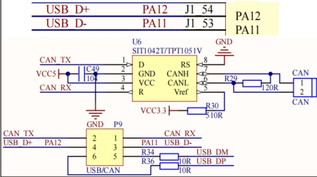

2- Could you please share the schematics part showing the STM32 and the CAN transceiver?

For the schematic diagram,: The CAN of the STM32F4 is connected to the SIT1042T/TPT1051V transceiver chip through the setting of P9 (a jumper cap), and then connected to the external CAN bus through the terminal block. CAN and USB share PA11 and PA12, so they cannot be used at the same time, and I have confirmed that the USB function is disabled and the jumper cap has been correctly connected externally.

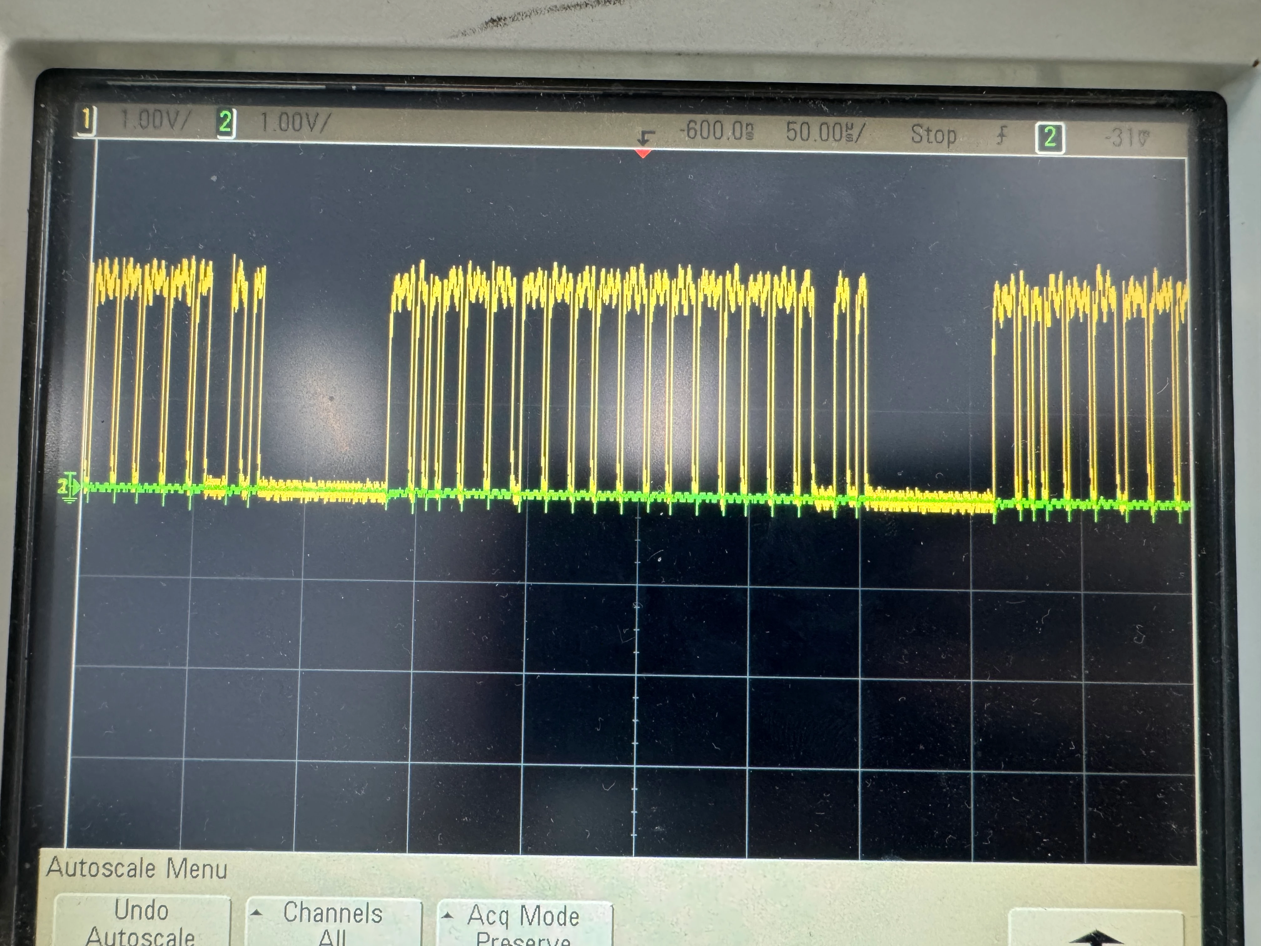

2. I used an oscilloscope to monitor the signal on the bus, connecting the X end of the oscilloscope to CANH and the Y end to CANL. The situation is very interesting:
2a: Without connecting the cable, start the host computer and start CAN transmission, the waveform on the bus is normal; then, connect the CAN cable to the STM32 board that has been powered on, the signal waveform on the CAN cable disappears, and even after unplugging the cable from the STM32 board, the signal cannot be reset
2b: Start the host computer and start CAN transmission, then connect the cable to the STM32 board that has not been powered on, the CAN bus signal displays normally; keep the cable connected, and then power on the STM32 board, the STM32 can read the data on the CAN normally and display it on the screen, but about 10s-45s later (this time is very random), the signal on the CAN bus suddenly disappears and cannot be restored
2c: If you connect the cable first, then power on the STM32 board, and then start the host computer and start CAN transmission, then the STM32 will only be able to read the first data frame, and then the bus signal disappears immediately and cannot be restored.

Oscilloscope:
What is X and Y? There's a special XY-mode, but that wouldn't make sense here.
Make sure you don't connect the scope probe GND to CANH or CANL - unless you are using a scope which is battery powered (and has no other ground connections) or a scope with differential inputs. Both are not really the regular kind, so maybe you killed the CAN bus by making it single-ended with the scope GND...
So, for monitoring the differential CAN bus with a regular scope, use 2 channels - but maybe that's what you meant with X & Y... :D
Anyway, as your CAN transceiver is not isolated, maybe you have a ground loop problem? Which might get worse with another grounded device (the scope). But if all the devices are on your desk, same power source, no long cables, this is probably not the problem.
most1maAuthor
Feb 25, 2025 7:11 AM UTC
Sorry I didn't make it clear. The X and Y I mentioned are actually channels 1 and 2. When testing, since my CAN cable did not lead out GND, I simply connected CANH to channel 1 and CANL to channel 2. The oscilloscope probe was not connected to anything else.
Speaking of this, I do think the signal returned by my oscilloscope is a bit strange. I think the CAN bus should be a differential signal, but the actual signal is very strange...
You don't have a signal on channel 2. So it's a hardware/wiring issue. Without both differential signals present, you won't get any signal going to the CAN Rx of the STM32.
Also, other than the PC and STM32, are there any other CAN nodes connected?

Probe on Rx pin of the transceiver instead of CAN_H and CAN_L. And see if you see any CAN activity on it.

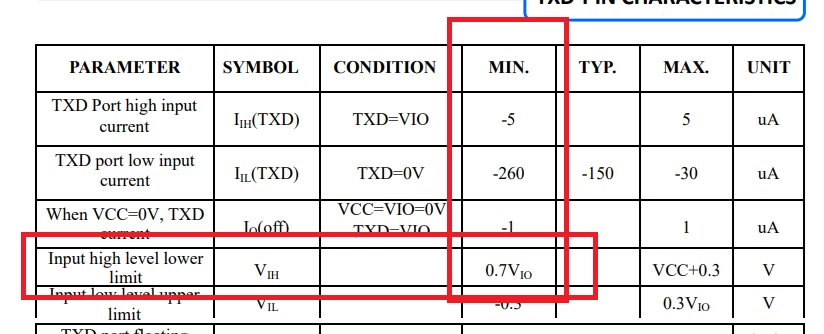

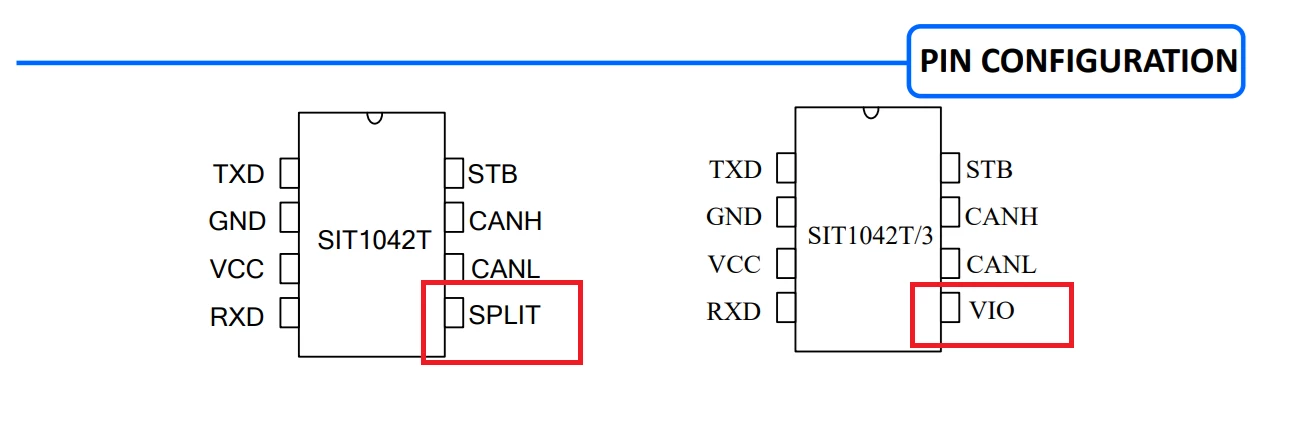

Another remark. I'm not sure which versions of the transceiver you have on the board? the VIO pin version? if not, the transceiver seems to be not suitable as VIHmin = 3.5V > VDD:

1- Probe the Rx pin from SIT1042.
2- Check if you have the VIO pin version of the transceiver:
Not related directly to the reception but it will be a problem to send the acknowledgement bit after reception.

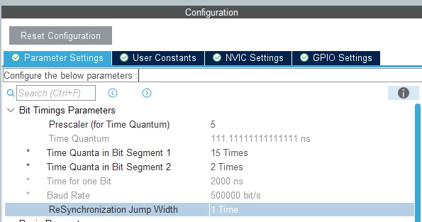

Your time seg 1 and 2 are pretty close to each other. The sampling point should be in the high 80s
Your values might be closer to ~30
try these values
