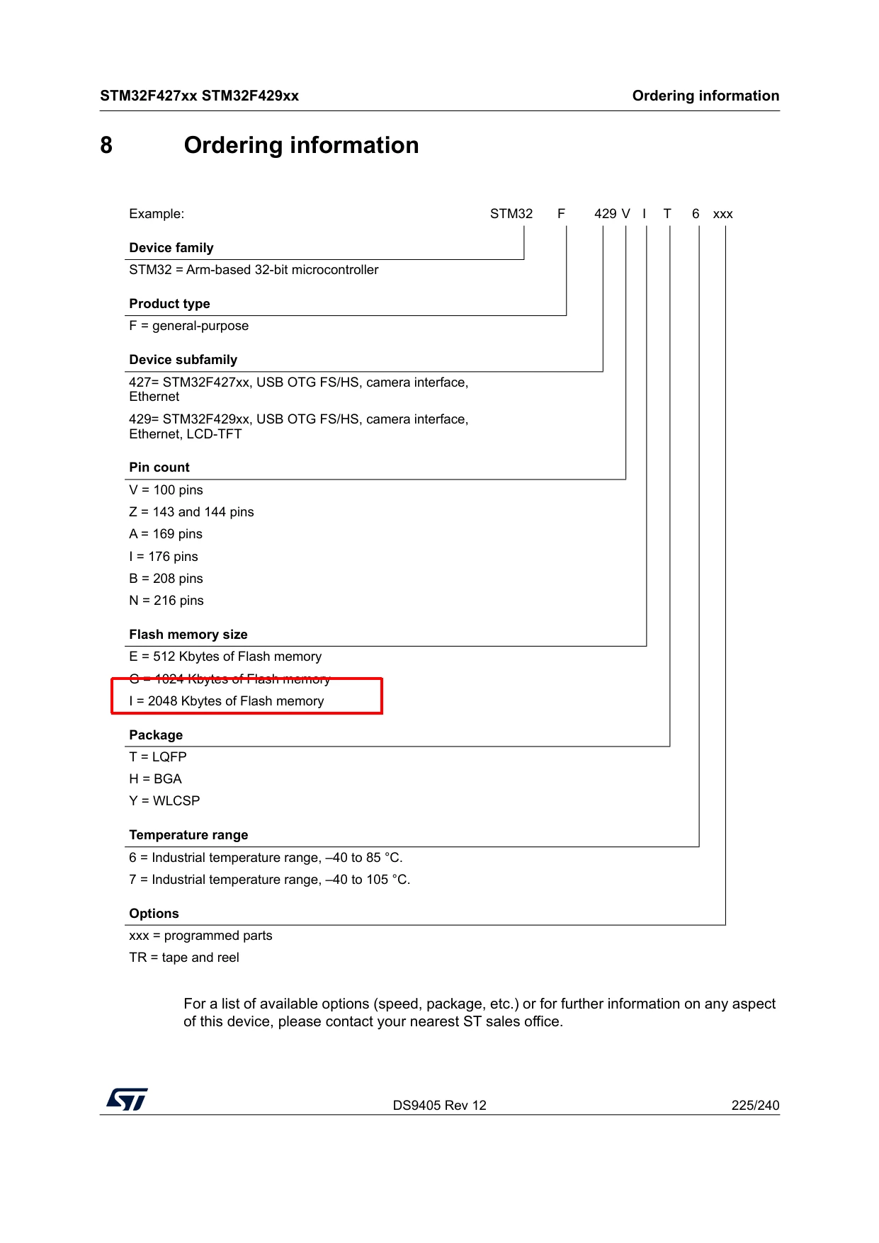

Could you please help me find out how much internal storage space this model STM32F427VIT6 has? Thanks a lot.

From STM32F427 datasheet : Flash and RAM:
From 8 Ordering information section:
I means 2MB of Flash:
Hope that answers your question.
