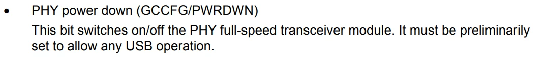

I am also using the external ULPI PHY, but when the USBD_Connect function executes, pin PB14 is lost. This is becasue the USBD_Connect function is enabling the internal PHY. I know there is a way to fix this but do not remember how. I needed to reinstall the whole environment so the fix was lost and now the code does not work since I need pin PB14 as a GPIO.

Hi @MBurg
It is pointing to this thread
https://community.st.com/t5/stm32-mcus-products/stm32f4-i2s2-pin-af-multiplexer-issue-s/m-p/465934
If OTG_HS_GCCFG_PWRDWN is set (transceiver power down is deactivated) the DM/DP pins are driven by USB.
OTG_HS_GCCFG_PWRDWN is necessary to be set only when using the HS instance.
