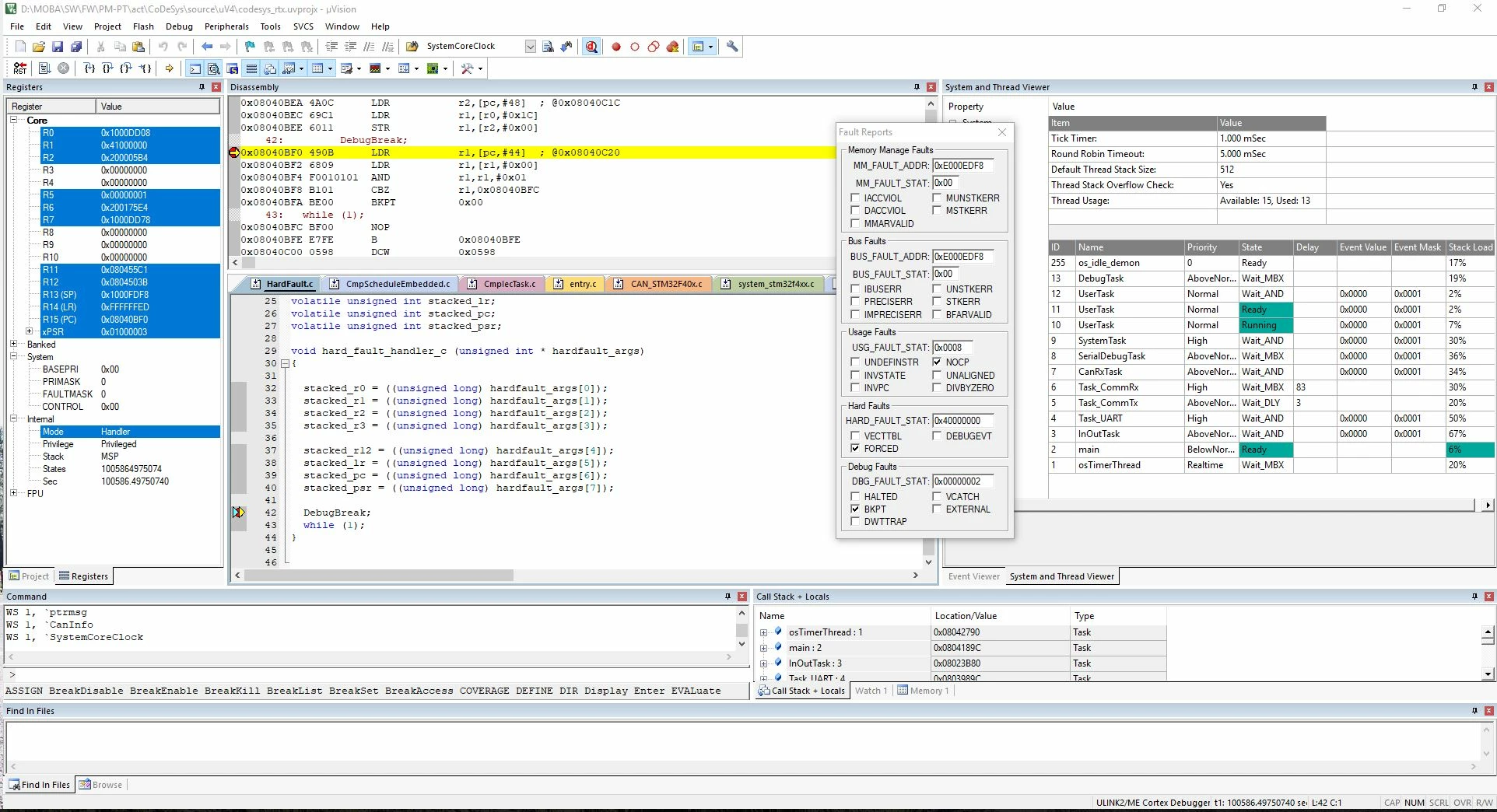

I need help, because we are facing hard fault with the STM32F427 MCU.
Same software over some MCUs works perfectly, over someother crash and we are not able to understand the reasons.
Attached screen shot of debugging sections.
Any Idea?
Many Thanks,
Diego

Looks like you use an OS and tasks, which makes it a bit more difficult.
I understand this as 'crashes on some boards, runs fine on others'.
This might be a clue, but not necessarily. I expect all boards (MCU's ?) to be identical otherwise.
Seemingly 'random' crashes are often cause by resource overflow/corruption (mostly stack) due to external, asynchronous events (interrupts).
The path name of your images imply CoDeSys, which is  ... not quite small.
Besides of providing more about your hardware/software environment, I would first work backwards, and decode the hardfault reason from the SCB registers.
Try more than one hardfault event. Is the place and context the same, or does it change ?
Second step would be presumably an instrumentation of routines possible causing it.

yes, the very strange is some board yes and some other not.
I've tried to replace the MCU and that board is now working properly, no more problems like before.
Some how I've the feeling it is the MCU having something, but honestly I'm not sure.

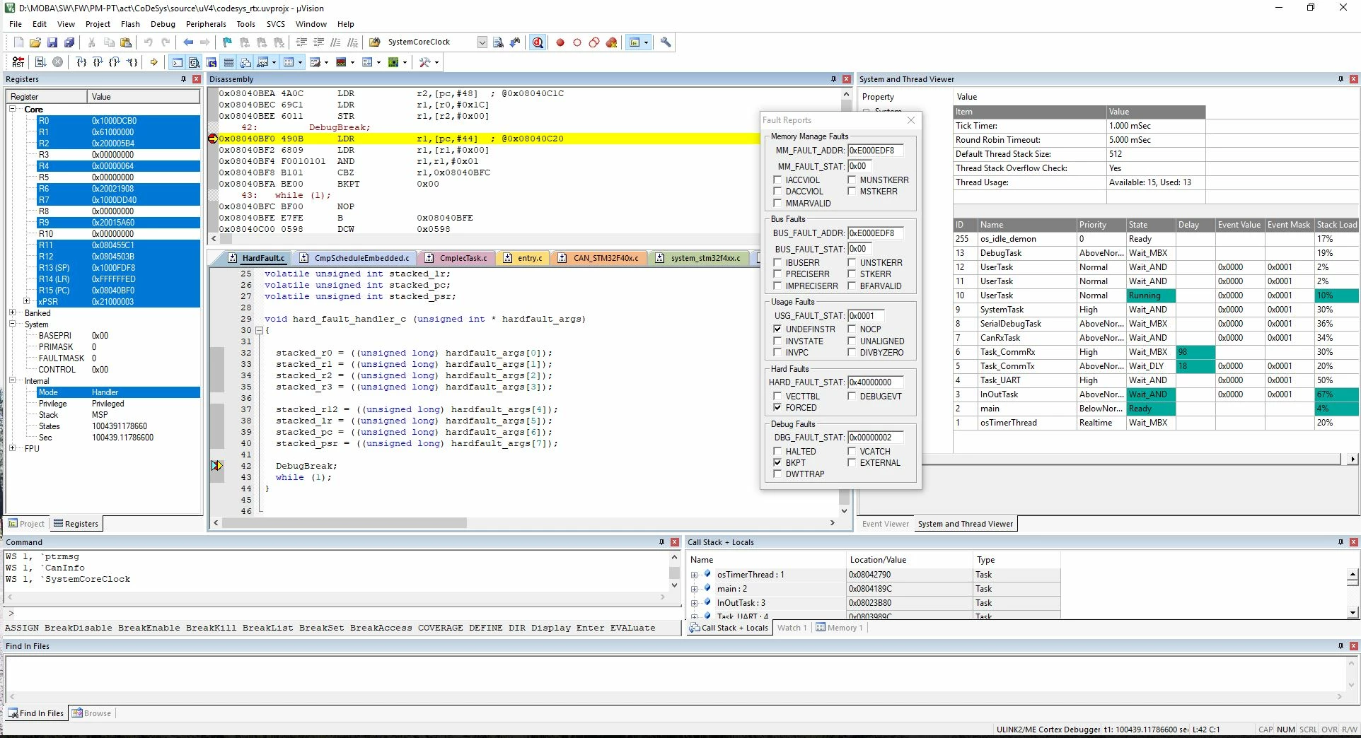

The place is not always the same, it looks that somehow there is a repetition of 5/6 different value of program counter, but...
Errors are NOCP, UNDEFINSTR, INVSTATE talking about Usage Fault, few times I get also Bus Fault PRECISERR.
Another strange things happening, is that if I place the PC to the value got by the hard fault handler, sometime the instruction is executed if I do that step by step, sometime that line is not executed, it looks the program stack there and no way to go further.
Where to see SCB register?
About interrupts, I was thinking about that, because a way to have more frequently the problem is to increase the amount of Tx/Rx interrupt fron CAN BUS interface. But again, very strange that on some board it happens quite easy and on some other board never.
Many Thanks and waiting further info.
This is a typical symptom of a stack overflow, when 'odd' variables are interpreted as return addresses.
I would use a stack-check feature. Some toolchains have this option, and FreeRTOS too.
This is another overflow symptom, because interrupts pound on the stack, too.
Though they (interrupts) are not the cause, they use to add a 'random' note, and complicate debugging.
Code instrumentation is good for synchronous problem (i.e. systematic bugs in the code), but not for stack overflows.
http://www.keil.com/appnotes/files/apnt209.pdf

Look at the code that's actually faulting.
For chip/board specific issues and instability, look at voltages and capacitors on VCAP pins.

We don't find the code that is faulting, because the PC is always different and it goes in place where code is normally working.
About hardware, could be a point. On one board only, the only one where we tried, by changing the MCU the problem looks solved. Maybe is not the microcontroller, but a soldering of a VCAP pin as you suggect.
I try to look.
Thanks
