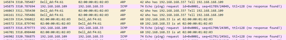

Hello friends,
I was originally using STM32F207, FreeRTOS,  LWIP ,ENC28J60 , system works fine.
Because I need more RAM, I migrated to STM32F427, but unfortunately network no longer works now, ARP seems working but Ping fail (Request timeout)
what could be problem?
thanks for your help
Kevin

    Posted on July 11, 2017 at 17:06
    Hello
    Lang.Kevin
    You may check with a LwIPexample under STM32CubeF4 with a similar type of your projectto deduce what is going wrong in your case.
    The workingexample available at this path can help you as an implementation example: STM32Cube_FW_F4_V1.0\Projects\STM324xG_EVAL\Applications\LwIP
    Regards
