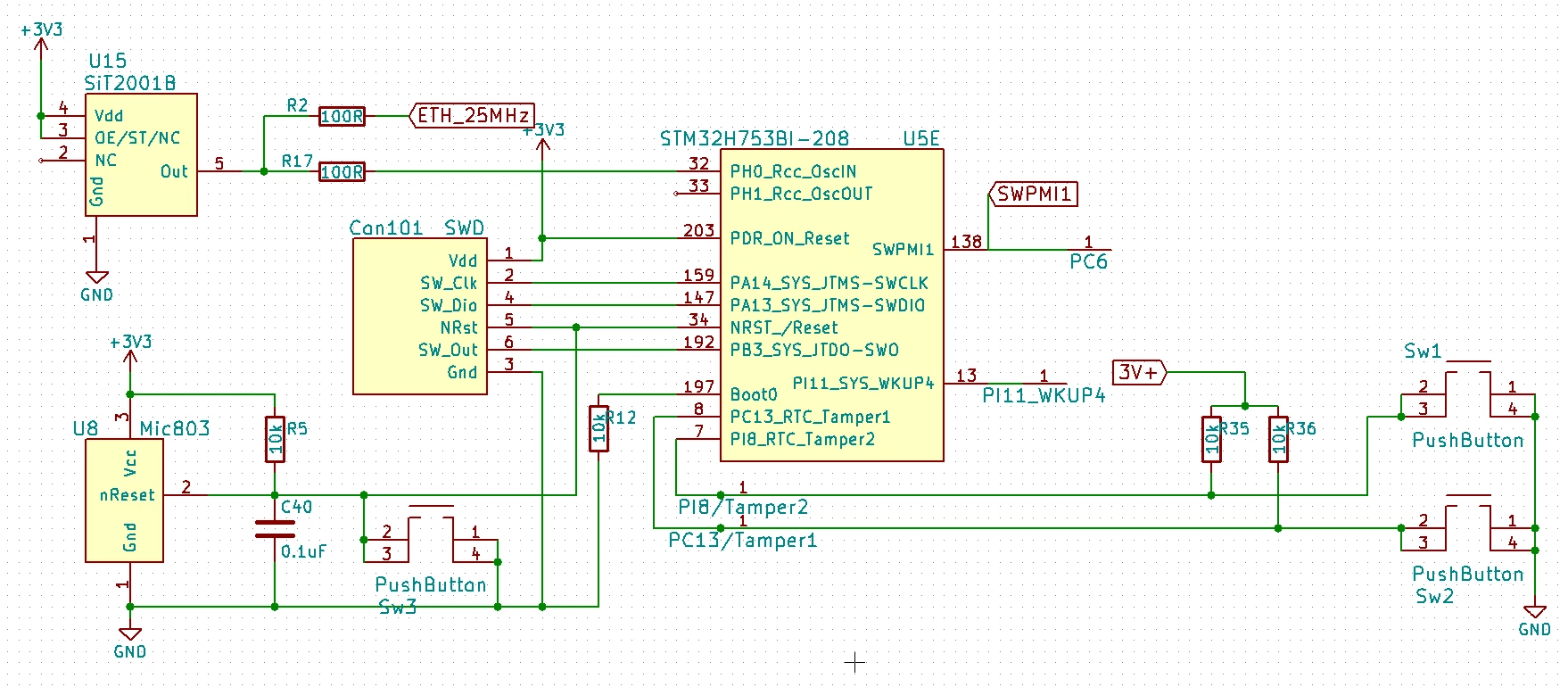

    The Reset pin needs a resistor and a Cap.
    You mentioned the 4k7, but you didn't mention the cap.
    I use a 10k pullup and a 0.1uF on the reset pin as a minimum, but its not 100% reliable, depending on the brown out duration.
    For 100% reliable startup, use the reset chip.

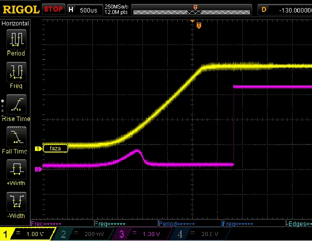

    Posted on April 27, 2018 at 16:27
    Bellow is a scope image,   yellow is the 3.3V supply line,  and purple is the reset pin.
    The measurements where taken at 500uS/1V division.
    I dont have capacitor on the reset pin
    What do you think?

    Posted on April 28, 2018 at 02:06
    I would say you definitely need a cap, is that 1uSec from power supply at 2.5v to Reset up ?
    did you check the reference manual ?
    page 29 of the F427 data sheet, VACAP has to be stable before Reset, can you check that ?
    you should check pages 25-29
    Page 97, NRST Pin
    page 138:   You need a 0.1uF, and no resistor ??
    Table 59. NRST pin characteristics shows:
    Time of NRST_OUT Generated reset pulse duration Internal Reset source 20 - - μs
    I can't see this 20uS running on your scope.
