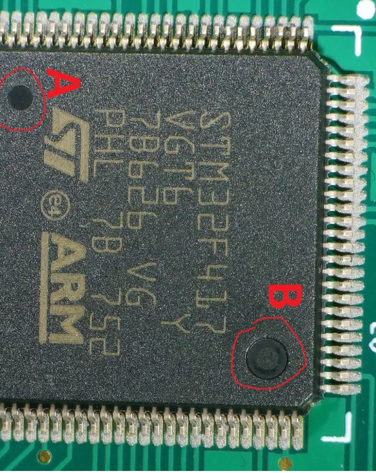

A is the Pin 1 designation, so the text is read-able western style. Pin 1 is on the edge Below the Mark
B is the Ejection Mold / Relief, these can be different depending on the production plant / line
Solder Paste be everywhere..

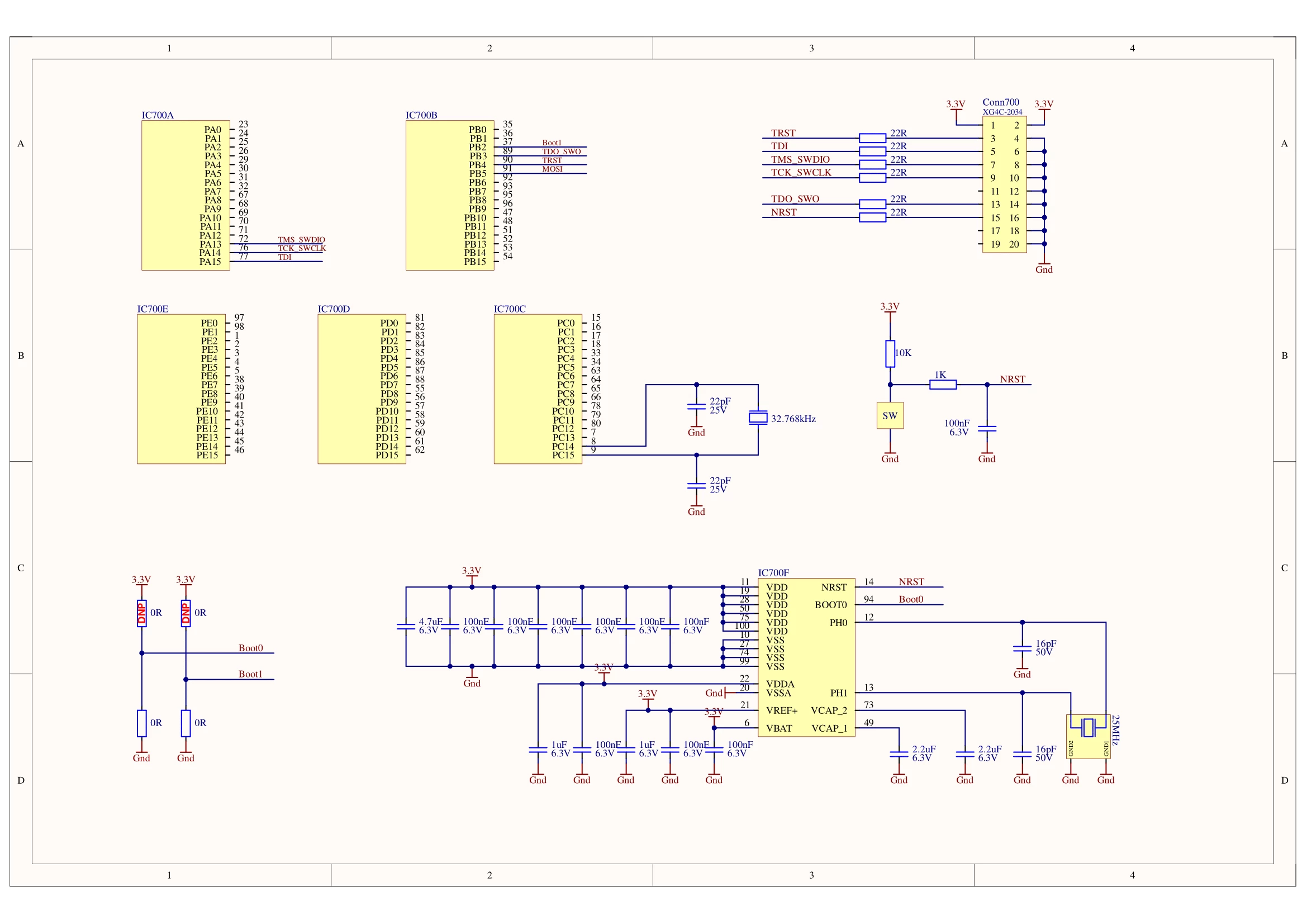

Dear @SalihKun ,
Share you schematics , please . And also a picture of the device Top marking to be sure it is genuine .
Ciao
STOne-32
SalihKunAuthor
November 13, 2024
Hello;
I am sorry for the late reply.

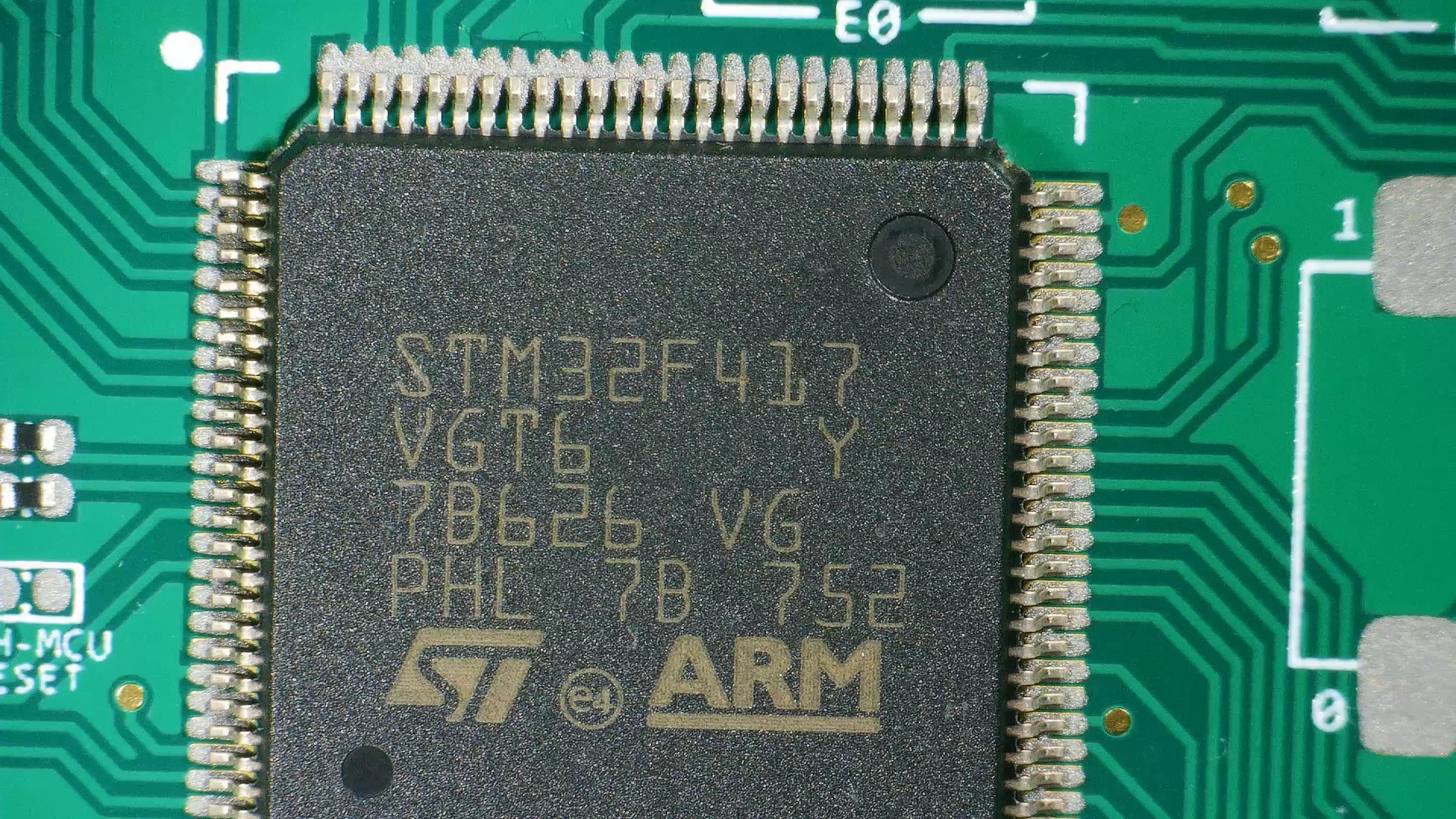

I am attaching schematics and an image of the chip recorded during assembly.
Looking for your help.
Thanks.
EDIT: Oh god, now that I am looking at the attached image "Chip under microscope.png", don't tell me I messed up with the chip orientation? Can anyone confirm it for me? Please!
gbm
November 13, 2024
Not only it's rotated by 90 degrees but also there are shorts between top left pins. Easy thing - should take no more than 5 minutes with hot air station and good flux.

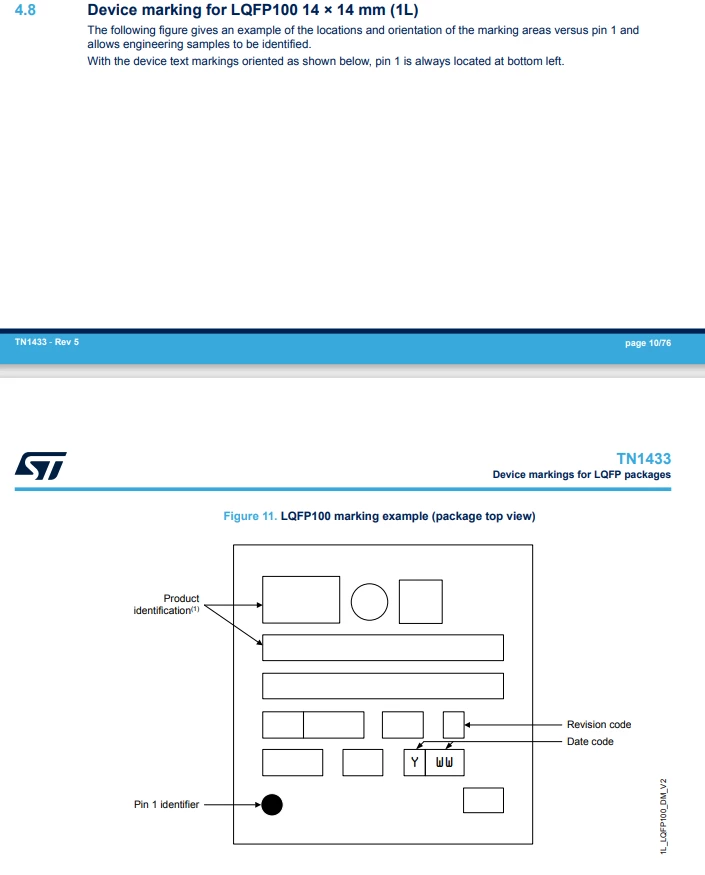

Dear @SalihKun ,
For more details on Pin1 marking, Here Reference device marking schematics for STM32 microcontrollers and microprocessors - Technical note
So you need to rotate your device versus PCB with 90° angle on right side like this
as I see your crystal pins are on left side of the screen.
Ciao
STOne-32.
