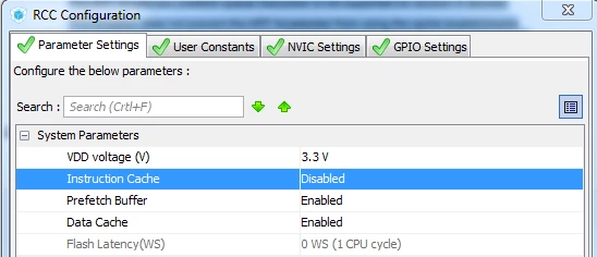

in your first project we use a STM32F415ZGT without any problems. Then we switch to the smaller version STM32F415RGT in a new design. With the same source code we got some times a hard fault when die MCU is booting up.
After two or three days of software and hardware bug finding and trying different versions of CubeMX and F4 firmware we find a solution to disable the Instruction Cache in CubeMX:
After that your simple LED blink code runs fine without any hard fault.

    What does DBGMCU->IDCODE report?
    What frequency and wait states are being used?
    Tobias Wedell
    Jan 8, 2018 3:42 PM UTC
    Posted on January 08, 2018 at 15:42
    IDCODE = 0x10076413
    SYSCLCK = 168 MHz
    WS = 5 (6 CPU cycle)
    waclawek.jan
    Jan 8, 2018 4:23 PM UTC
    Posted on January 08, 2018 at 16:23
    Is the supply voltage 3.3V and is it stable and well-decoupled? What's the voltage on the two VCAP pins, are they properly connected? Is PWR_CR.VOS=1 all the time? Are all GND/VCC pins connected properly, including the analog ones and VBAT?
    Tobias Wedell
    Jan 17, 2018 12:56 PM UTC
    Posted on January 17, 2018 at 13:56
    the problemwere theferrite beads in the VSS and VSSA lines. Bridged them and all is working fine. Many thanks to
    Waclawek.Jan
    for the hint.
    I leave the VCAP capacitor as it is at 2.2µF.
