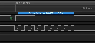

I am using a STM32F415RGT6 embedded in the 1Bitsy Board. I want to set up the I2C Peripheral in order to read some data from a sensor.

After that I want to write a 0x00, but the code always hangs in the last line, apparently the Master never reads the acknowledge. The I2C status registers always read:
I2C1 -> SR1 = 1024
I2C1 -> SR2 = 3
which means that the Acknowledge Failure bit is always set. If I analyze it using my Saleae I get the following:
The Slave sends the ACK, but the STM32F415 cannot read it.

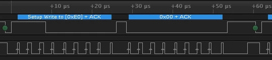

The weird thing: If I try the same code on my F407 - Disco (only with clock set to 400khz, but it's the same behaviour on both MCUs regardless of Speed), it works flawlessly:
All other peripherals work fine. I already tried several workarounds, but the AF bit is always set, regardless of method. I hope you can help me.

Well, I found the problem. It just don't work with the F415 with the logic analyzer measuring SCL and SDA. If I remove the analyzer it works. With the F407 it does not matter if it is plugged in or not. Well, that were 8 wasted hours of debugging. Thanks to all who tried to help me!

Albeit, logic analyzers are not always a good substitute tool for scopes (like for the I2C bus at this speed).
