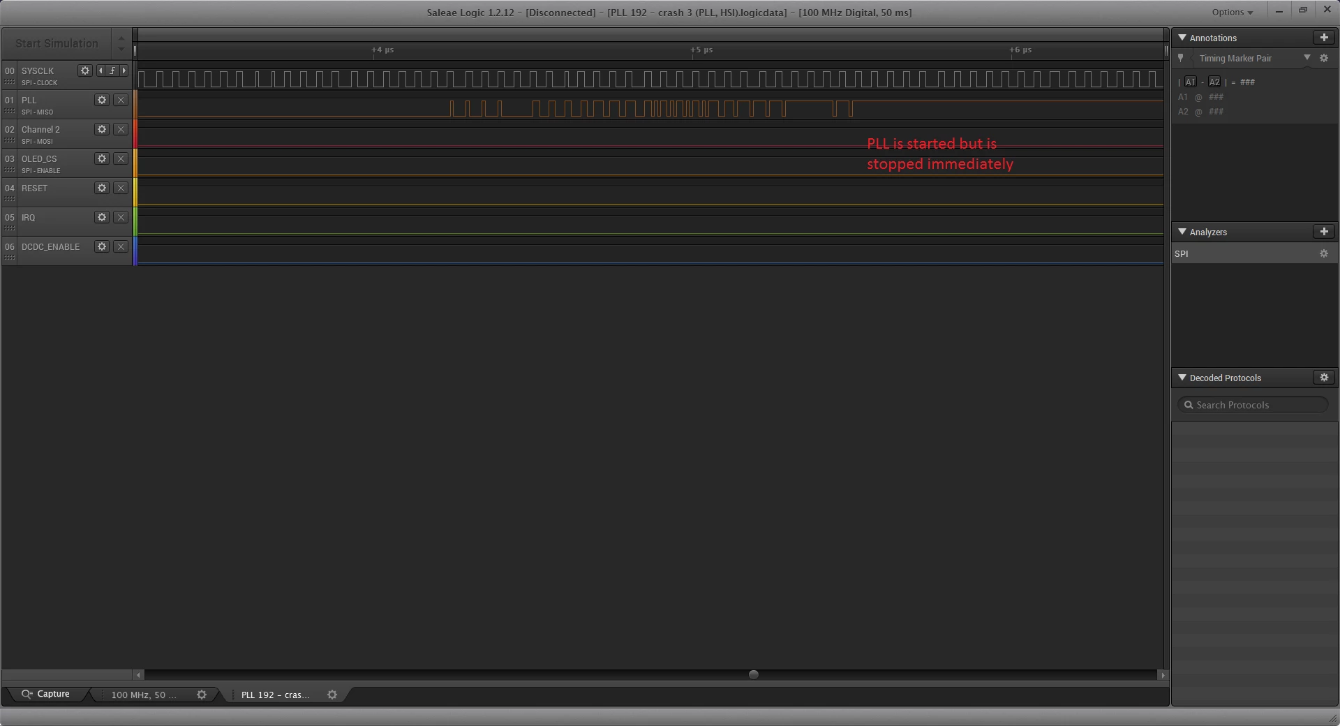

    We tested the MCO pins. Clock frequencies seem normals.
    We noticed that sometimes the PLL clock stopped. But we do not know if it is the micro which crashes and stop the PLL or the PLL which stops and crash the micro.

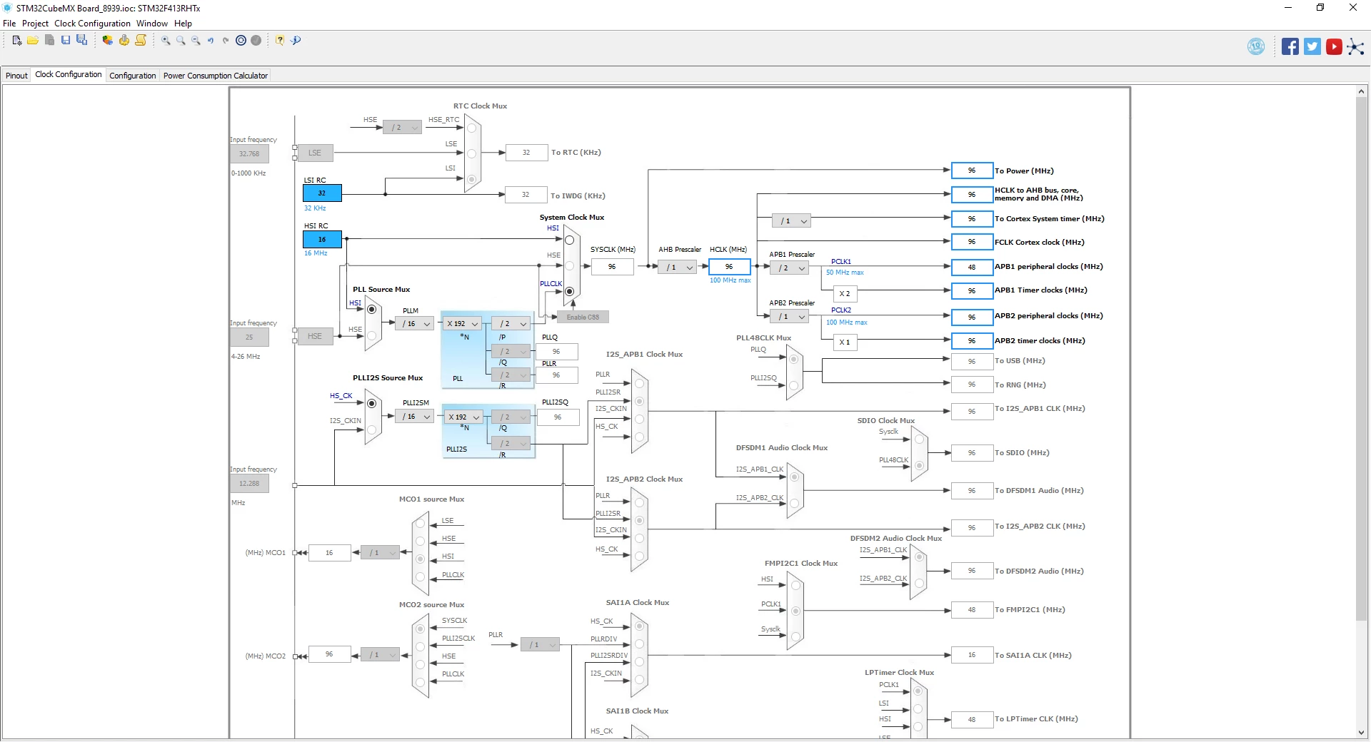

    The APB1 prescaler is set to 2. We use CubeMx to configure the clock and there are no highlights.
    The generated code:

    I think the configuration is good, because it works well on a Nucleo.
    But on our custom board it does not work and we are searching ways of investigate this problem.

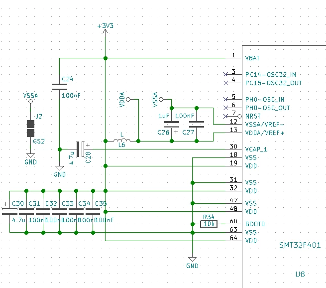

    have an identical problem but with STM32F401RBT6, on nucleo all works, on my PCB fault as above. Errors are sometimes different(INVSTATE, PGSERR, PRECISERR, BFARVALID, BFAR, MMFAR, PGSERR) and occur in a random program location, at about >50-60Mhz, regardless of the periphery.
    EDIT: The problem solved ... the Vcap 4.7uF capacitor must be really low ESR, or better 2x2.2uF.

    NRST is not connected in your diagram ??
    I use a reset chip on NRST, MIC803 triggering at 2.9V for 1.2Sec.
    NRST requires a 0.1uF and a 10K or 1K pullup.
    VCap 2 also requires the Low ESR 2.2uF

    In my application, an internal POR / PDR is enough.
    The NRST pin is internally pulled 40k, so an external resistor is not needed in most cases.
    I have connected 0.1uF to ground (error in the diagram above).
    I would highly recommend AN4488: Getting started with STM32F4xxxx MCU hardware development.
