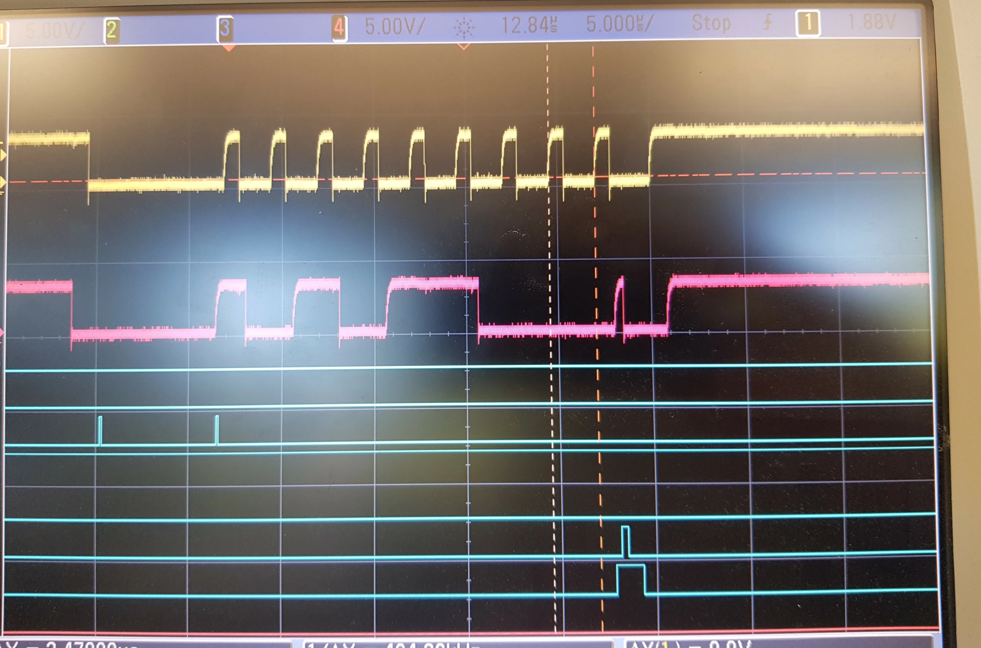

Hello everybody,
I am having an issue when I try to establish a communication with the NFC chip M24SR64 via I2C. After I have sent the address (0xAC), the flag AF is set, indicating that the ACK of the slave was not read. However, I can see the ACK from the slave in the Oscilloscope, i.e., during the 9th SCL pulse the SDA line is in low (see attached picture). Then, in the error handler subroutine for the AF case, a STOP condition is generated. I repeat the process many times but always the AF flag is set.
I am pretty sure my I2C settings are right (PF0 and PF1 as open drain outputs, high speed, alternative function, etc). In fact, the I2C driver works flawlessly in the STM32F446. I compared the two reference manuals and there is no difference in the I2C modules of the controllers.
The pull-up resistors value remained the same (3K) . I also attached my initialization code.

    I think it is not recognized as ACK, because it is no ACK.
    The slave is supposed to pull SDA low while SCL is high.
    What you see is IMHO the master switching back the direction of the SDA line.
    SDA is output for the 8 data bits, and input for the ACK bits.

    I though it would be enough for representing an ACK that SDA remains in low while SCL is high, during the 9th SCL pulse. Actually, I changed once the address for checking the slave response and the SDA line was kept high at the 9th SCL pulse, which means that the chip rejected the wrong address.

    For the 9.th ACK pulse, the master switches SDA from output to input before clocking the pulse out.
    The pull-up resistors will keep SDA high, resulting in "NO ACK" if the slave does not actively pull it down.
    When the ACK pulse is done, he switches back.

    I saw as well the signals using the STM32446 and the SDA line remained constant in the low level during the 9th pulse (before it too since the last bit of the address is 0). With this controller, the I2C communication works without any issue as I mentioned above. It seems to me really strange since there is absolutely no difference between the I2C modules of the two controllers. Perhaps it is worth to mention that I needed to reset the CR1 after disabling the module because the BUSY flag was stuck at 1. This workaround was not necessary using the 446 controller. Perhaps there is an additional workaround for this issue with the AF flag. Unfortunately this is not mentioned in any erratasheet. Or maybe is it necessary to adapt the value of the pull-up resistors.
