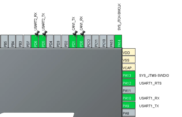

Hi, guys!
I'm using a board developed in my company that uses a STM32F413VGT3. It has a MCP2551 and I have to use CAN BUS to comunicate.
The problem is that we're using PD0 and PD1 as CAN1_RX and CAN1_TX, because PA12 is used to USART1_RTS. I'm able to receive data from CAN but I can't send anything. I've used the same code in another board with STM32F103 without a problem (using the standard pin map), so I think that the problem is at alternate function of PD0 and PD1. I used STM32CubeIDE to do the remapping and it seems ok to me in function HAL_CAN_MspInit.
Is there any knowed problem with alternate function of can pins? Any ideas of what should I search for?

Ive just found the problem. It was a problem with mcp2551.
