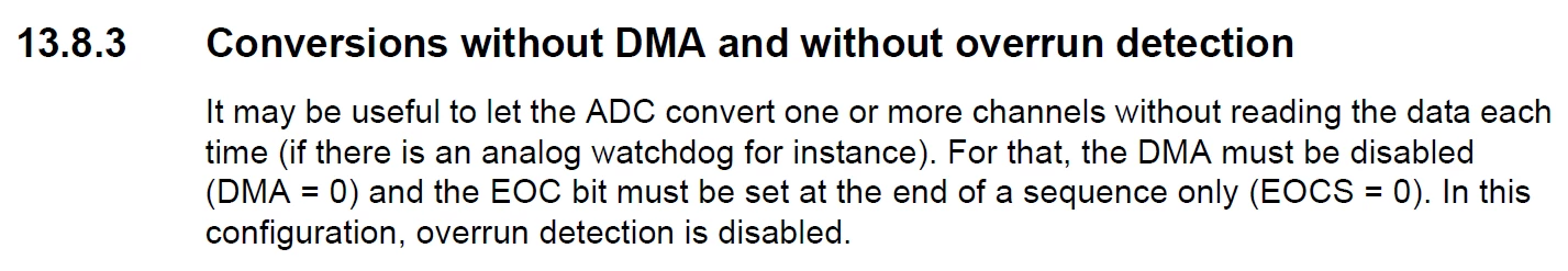

If you just need a single channel, set it to monitor continuously (or off of a timer). You don't need to read the values with DMA for the watchdog to work.
Unsure how to do this with HAL exactly, but there's likely a way.

Thank You @TDK​
That worked :D
Below is the working HAL code. Thanks again!
