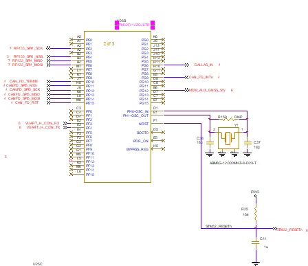

my design equipped with STM32F412ZGJ6TR
When applying reset command my STM does not wakeup
We have produced many PCBAs till now without any issue relate to reset mechanism.
The external Hardware reset that was implemented contain Pull-Up resistor of 10K and 1Uf capacitor connect to NRST line
The Scope show that when applying software reset this PIN (NRST) fall to 1.3v (From 3.3VDC) and return to high within 50msec
When changing the RC (replace capacitor to 0.1uf) the NRST dropped to zero but still my STM does not wakeup
