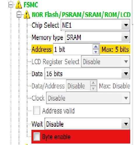

I am big fan of the Discovery boards and whenever I buy a new one I try to configure it using CubeMX.
As you know the provided examples are NOT generated by the CubeMX and there is no CobeMX project files available.
So you need to create project file by yourself.
This time I bought STM32F412G-DISCO and tried to reverse engineer the BSP driver to understand what setting should be selected in CubeMX do generate the same FSMC settings as seen in BSP driver.
The stm32412g_discovery.c contains the following code snipped related to FSMC:

I would like to learn what should be selected in CubeMX to have the same setting automatically generated.

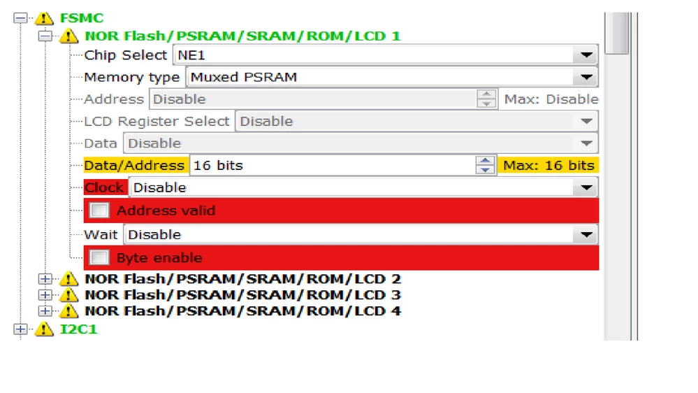

    For someone who is interested in.
    I tried again and concluded that the following setting to bring up LCD alive are as follows:
    Now you can call BSP_LCD_Init() and subsequent API to select colors and put text/graphic on the display.

    I also managed to use the Touch Screen - the reset pin (CTP_RST_Pin) was wrongly set to RESET value.
    So all works fine  - the CubeMX can generate right drivers.
