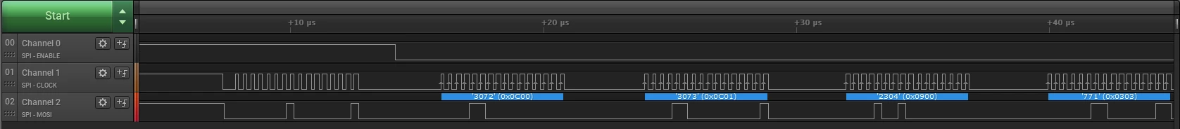

I am trying to transmit through SPI to a MAX7219 chip on my STM32F412G-Discovery board. The system clock is running at 100 MHz. I am using a level shifter to handle the 3.3V -> 5V voltage changing. I have used this IC on an arduino so I do know it works.
I am trying to transmit through HAL_SPI_Transmit and manually controlling the CS line through GPIO.
I am transmitting SPI with this code:
HAL_GPIO_WritePin(GPIOA, GPIO_PIN_4, GPIO_PIN_RESET);
uint16_t spiData = 0x0C00;
HAL_SPI_Transmit(&hspi1, &spiData, 1, HAL_MAX_DELAY);
while (HAL_SPI_GetState(&hspi1) != HAL_SPI_STATE_READY);
spiData = 0x0C01;
spiData = 0x0900;
spiData = 0x0303;
HAL_GPIO_WritePin(GPIOA, GPIO_PIN_4, GPIO_PIN_SET);
PA4 -> CS (set up as manual GPIO)
PA5 -> SCK
PA7 -> MOSI
My SPI1 init code is:
static void MX_SPI1_Init(void)
 /* SPI1 parameter configuration*/
 hspi1.Instance = SPI1;
 hspi1.Init.Mode = SPI_MODE_MASTER;
 hspi1.Init.Direction = SPI_DIRECTION_2LINES;
 hspi1.Init.DataSize = SPI_DATASIZE_16BIT;
 hspi1.Init.CLKPolarity = SPI_POLARITY_LOW;
 hspi1.Init.CLKPhase = SPI_PHASE_1EDGE;
 hspi1.Init.NSS = SPI_NSS_SOFT;
 hspi1.Init.BaudRatePrescaler = SPI_BAUDRATEPRESCALER_32;
 hspi1.Init.FirstBit = SPI_FIRSTBIT_MSB;
 hspi1.Init.TIMode = SPI_TIMODE_DISABLE;
 hspi1.Init.CRCCalculation = SPI_CRCCALCULATION_DISABLE;
 hspi1.Init.CRCPolynomial = 10;
 if (HAL_SPI_Init(&hspi1) != HAL_OK)
 Error_Handler();
I checked my logic analyzer and all the waves looked fine. I feel like I am probably missing something simple that's going to make me feel stupid.

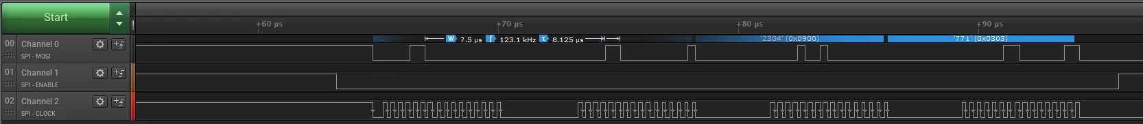

August 7, 2020
The problem is that the MAX7219 chip doesn't work (change state at all). I've tried several of the LED displays I have with this chip and none work. It doesn't even turn on or accept any of the commands, it seems. I tested the same commands on an Arduino SPI and it worked fine. So it's something I am doing wrong with the SPI on this STM32 chip.
The example compiles and if I write 2 as an argument instead of 1, then it outputs 32 bits instead of 16. I have verified that with both a logic analyzer and oscilloscope.
The example below shows where I send 1 byte. The clock pulses 16 times and it does send the full packet each time.
If I change it to 2 bytes, then I get 32 clock pulses and it sends invalid data. 0693W000003OlT0QAK.png

Your SCK line should be idle low according to the datasheet, but the logic analyzer shows it high as you lower CS for the first time. Transmit a dummy byte with CS high first to get it into the correct state, then do CS low and send the commands you care about.
Data should be latched on the rising edge according to the datasheet. Your logic analyzer is latching data on the falling edge.

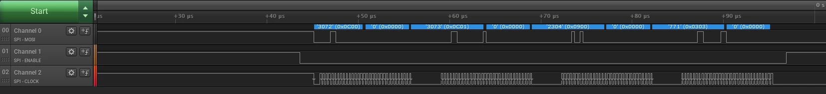

I tried that but it seems to have no effect. The latching issue seems to have been from the clock not being low when CS goes low.

If the signal sent on the SPI lines is correct, but the chip doesn't respond, it's not an STM32 problem.
Look at the signals sent by the Arduino to see a difference.
Take an analog capture to check for signal integrity.
Gotta be an answer somewhere.
