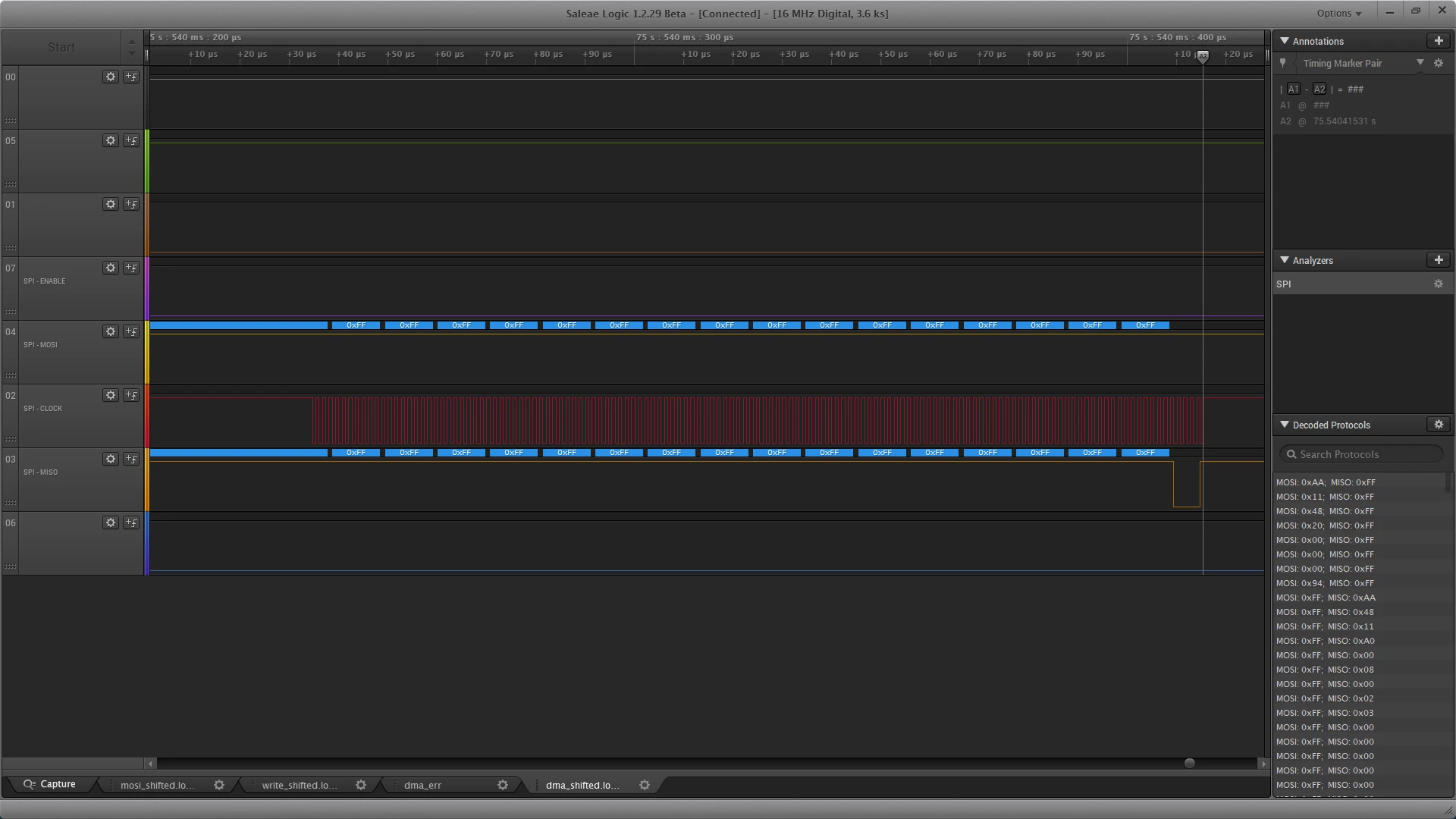

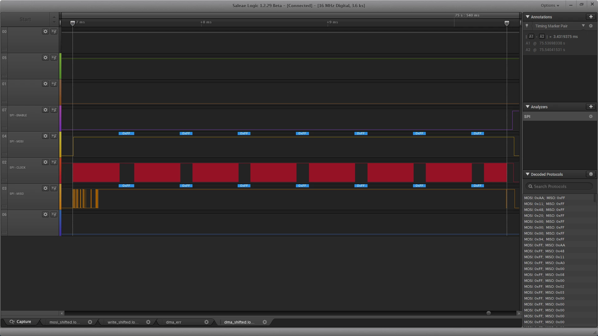

Hi.
First of all, the essence of my problem is already described here - https://community.st.com/s/question/0D50X00009XkiXu/spi-dma-data-corruption?t=1567119350874
In my case bug happens randomly and not very often. It could be one corrupted transaction among hundreds-thousands.
For example, how it is should work:0690X000009akJJQAY.png
First byte always is 0xAA.

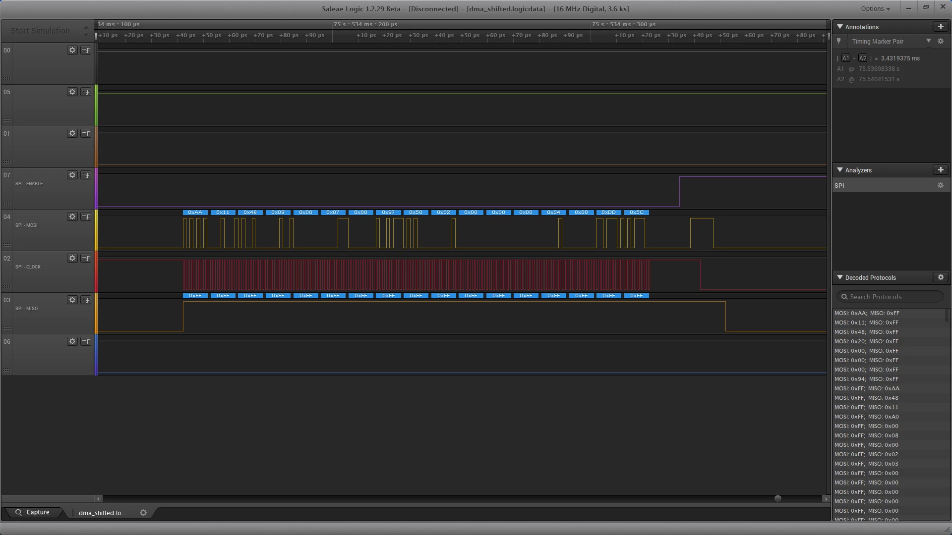

Here is an example of corruption:
You can see that CLK signal has already started, but data on MOSI is delayed by 5 bits (not constant, can be 4, 3...).
My code: https://pastebin.com/X3CfdH4q
And settings: https://pastebin.com/GKWTC1QH

I have checked content before this calls:
SPI_I2S_DMACmd(spi, SPI_I2S_DMAReq_Tx | SPI_I2S_DMAReq_Rx, ENABLE);
DMA_Cmd(dma_rx_stream, ENABLE);
DMA_Cmd(dma_tx_stream, ENABLE);
And after end of transaction (DMA_IT_TCIF2 bit is set).

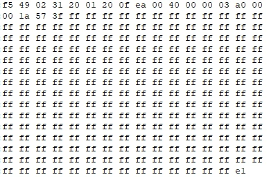

Data in DR register "after" - 0xE1.
Content of RX memory buffer (should be AA 48 11 89 ..... FF FF FF FF):

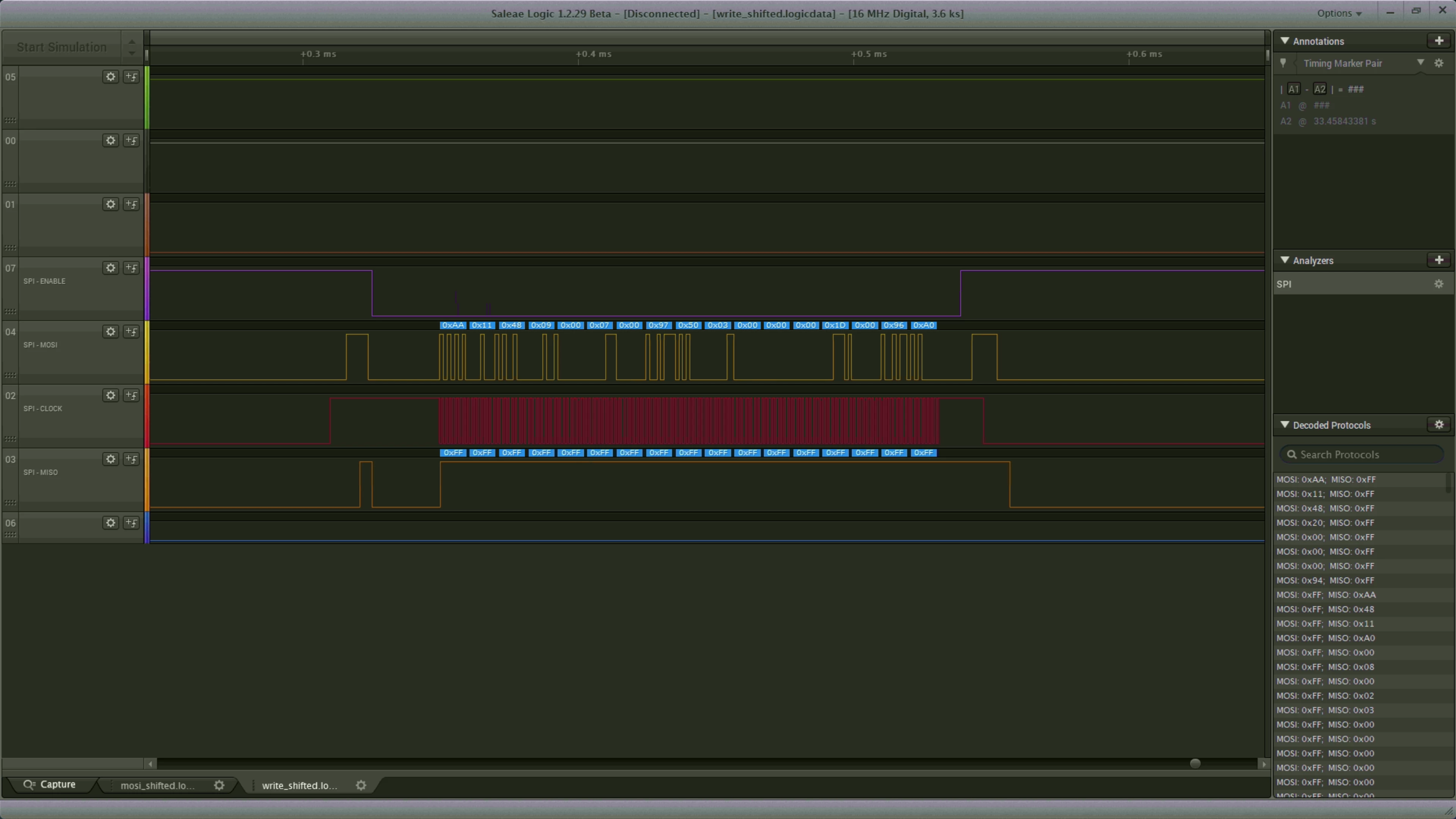

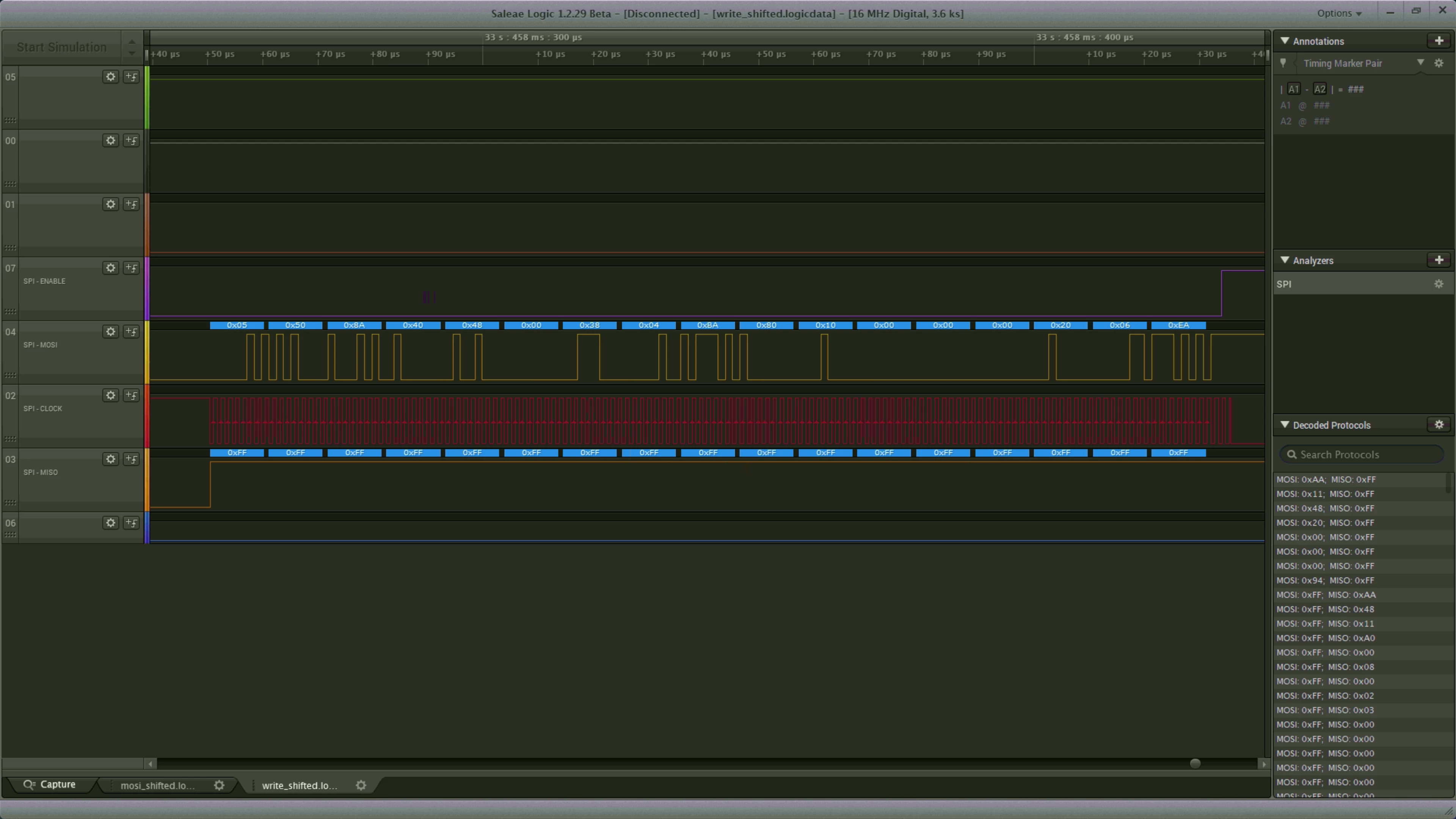

How entire transaction looks:
The beginning of it (in this case I send all 0xFF bytes):
And the end:
waclawek.jan
August 30, 2019
Looks OK.

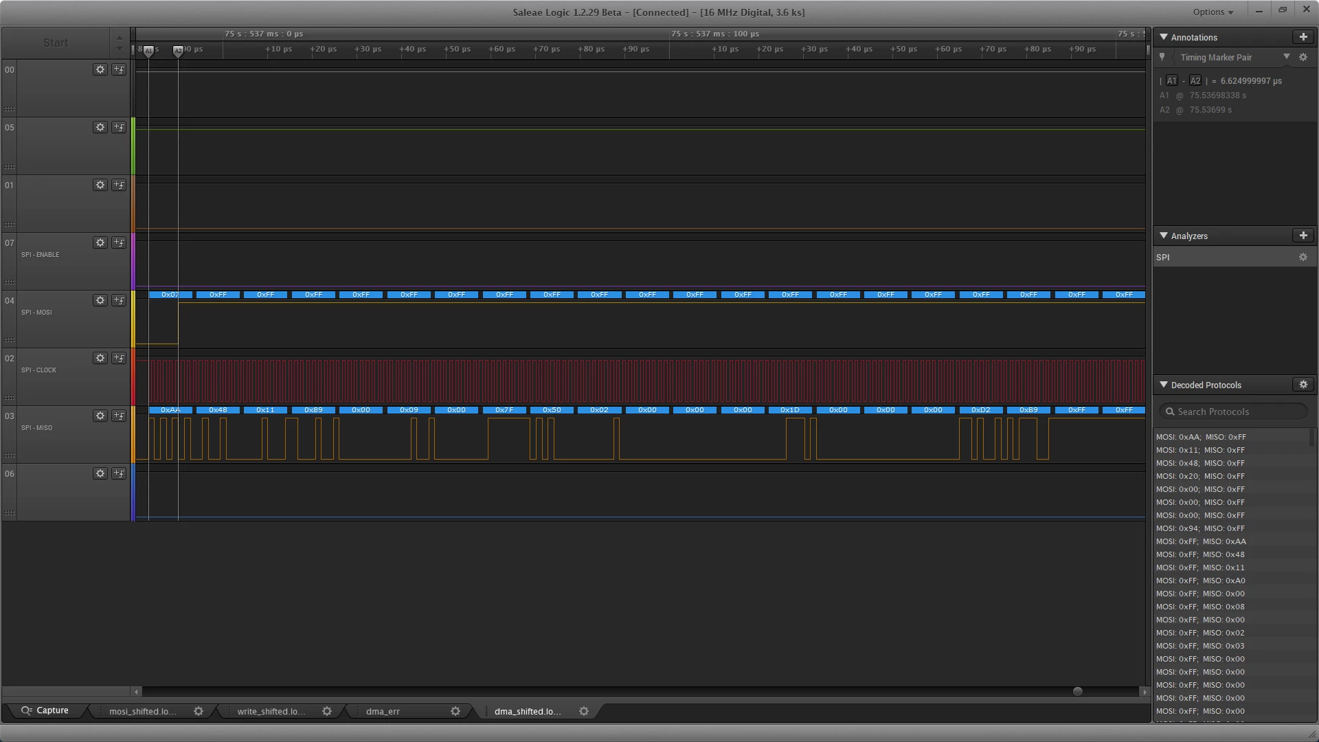

Here is "prev" transfer:
And Saleae Logic scope file (wrong transfer marked by timing markers):

Sorry I don't have the Saleae analyzer and don't intend to install the program. Can you please cut out the "previous" and "corrupt" transfer and place them next to each other?
[EDIT] Okay maybe it's not that necessary. Try to answer the following question first, and then perhaps mitigate it - if the signals are floating, try to set pullups/pulldowns as appropriate, especially to SCK [/EDIT]
Also, what is the SPI_ENABLE signal? And why are the SPI signals changing after the transfer ended?
Thanks,
waclawek.jan
September 10, 2019
> After end of the transfer I execute disable and deinit SPI (including clock disable - RCC_APB2PeriphClockCmd) and change MISO/MOSI/SCK pins to INput mode with pull-down.
Okay, so don't do this. Leave the SPI on. And, as as you CPOL so that SCK is high on idle, don't use an pulldown, us a pullup to avoid any transition on SCK.
I'd say, the exact sequence how you re-enable the SPI includes a period, where the SPI is slave and its clock is floating, resulting in the internal clock-counter to be shifted out of 0 and remaining so even if switched to master. The bunch of pulses on MISO in the "corrupted transfer" at the moment when the _ENABLE signal goes low is IMO not a coincidence.
