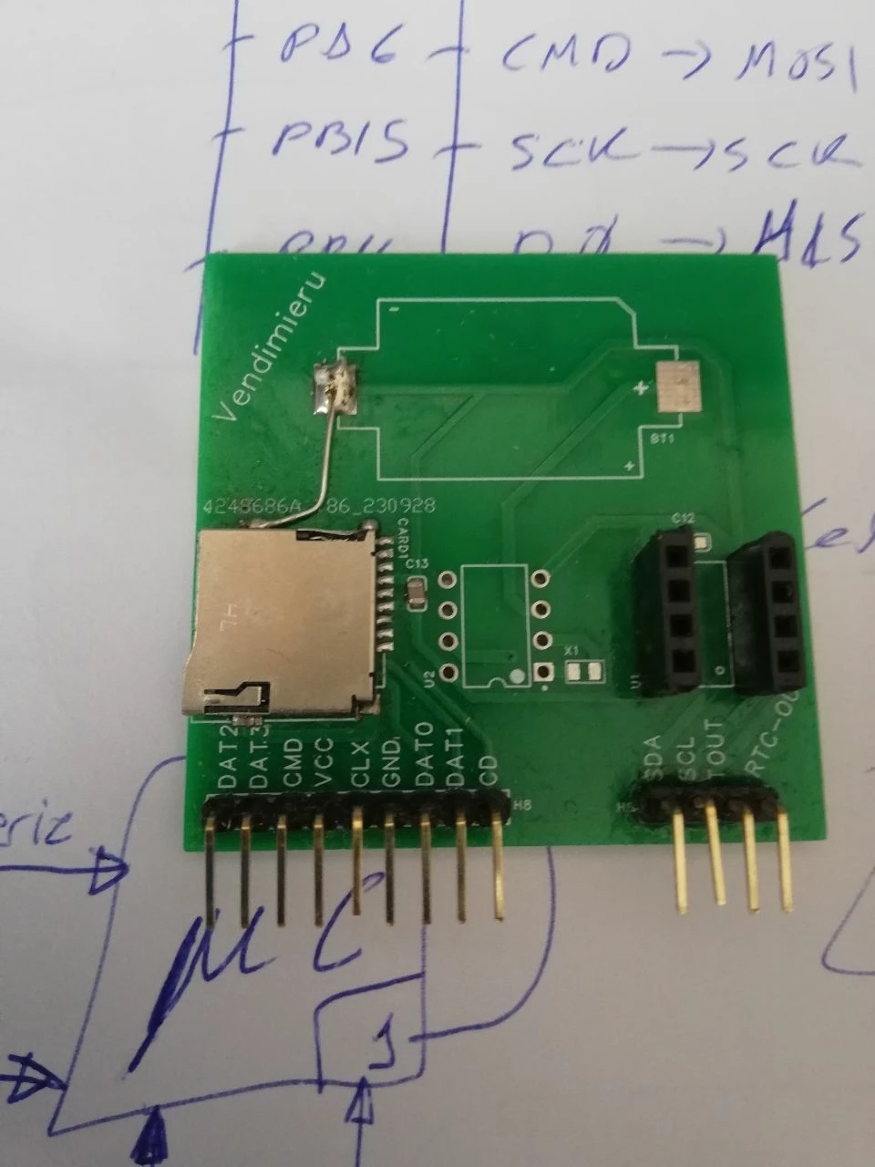

If you're able to get the examples up and running, perhaps adapt that code to your board.
Long pigtailed wires on SDIO traces are not ideal. These signals are typically 48 MHz and won't work over long traces acting like antennas.
Might want to expand upon the details of "I wasn't able to get working".

Just from my experience :
- wires cpu -- sdcard should be < 50mm (short wires !)
- try with 1 bit (=standard) at first
- dont drive clk to high , 50MHz is max.
- try port/pin speed setting medium or high
- set pullups ON (on all lines)
Then it should work.

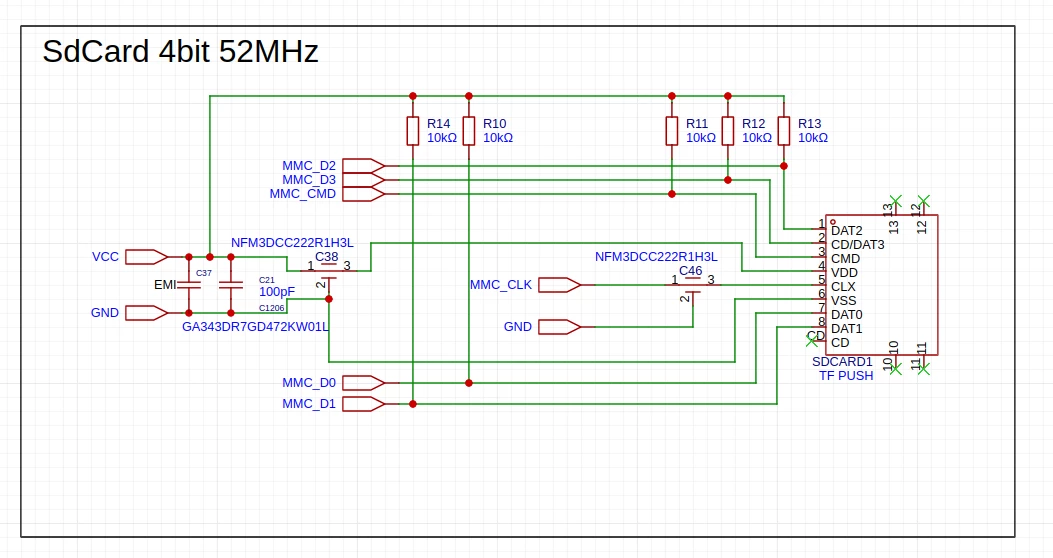

A schematic of the card might work better and a picture in expressing the circuit.
As @AScha.3 mentions, you want short/even cables, pull-ups a the socket, the WaveShare SDIO  boards are a good example of an ideal circuit.

This is the schematic of the SD card test board, and it works fine with Espressif.
