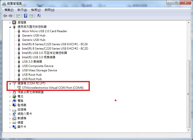

STM32F412 CDC feature fail from STM32CubeMx
Posted on April 26, 2017 at 04:42
I using STM32CubeMx generate code for STM32F412 USB CDC mode, but it's not work. However, I using STM32F072 MCU that it's work now.
Could anyone tell me what happened?

    Try increase heap and stack sizes in the CubeMx setting.

    I try increase heap and stack sizes, it's work now.  Thanks a lot!
