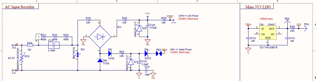

It has a "Capacitive power supply" so it is very limited power (16mA @ 16V), rise time for the voltage rail is in ms.

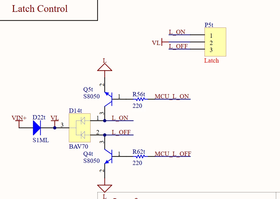

The meter has Latching relay. We are driving this latch through GPIO & npn as shown in the schematics pic.
My bad design, I didn't put a pull-down resistors in the latch control lines.
During startup the latch control (MCU_L_ON & MCU_L_OFF) are float, till the FW boots and set the GPIO to 0.

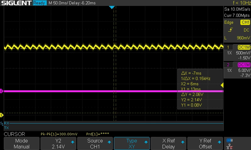

Out of 50 produced & flashed: 40 pcs success in booting. 10 didn't success. The failed ones has consistent behavior of having voltage of 0.6v on MCU_L_OFF which makes the npn turns ~ on and draws current, so the voltage in the power supply won't increase as it should. Vcc (3v3) voltage stays around 2.2v. it has small oscillations but never fall below 2v. If latch control disconnected, no issue occur.
latch control

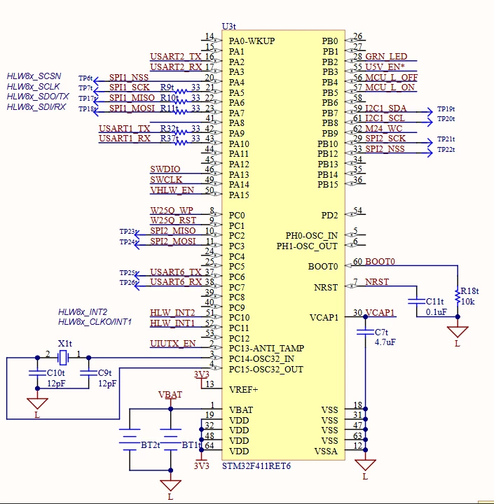

stm mcu
We don't have brown out enabled. Only the watchdog through configuration bytes with 0.5s default time.
The current booting sequence: GPIO initialized, Watchdog initialized, rest of the FW modules are initialized.

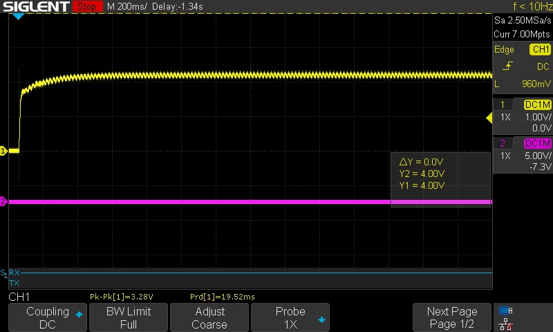

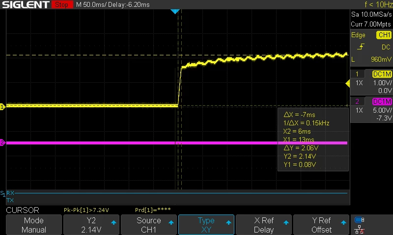

VCC during startup.

Regarding Q3.
The measured voltage is 2.2V DC.
The oscillations has ~ 150mV p.p & ~ 55Hz.
What else is required?
