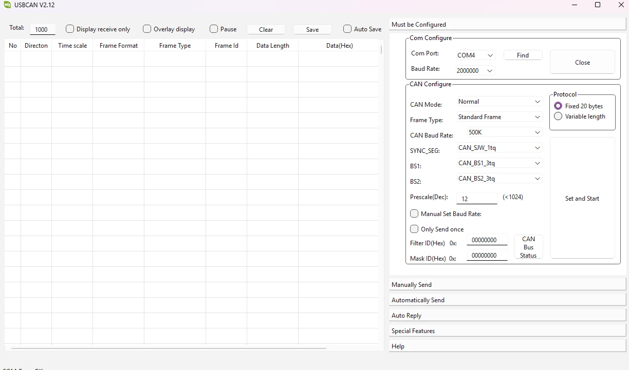

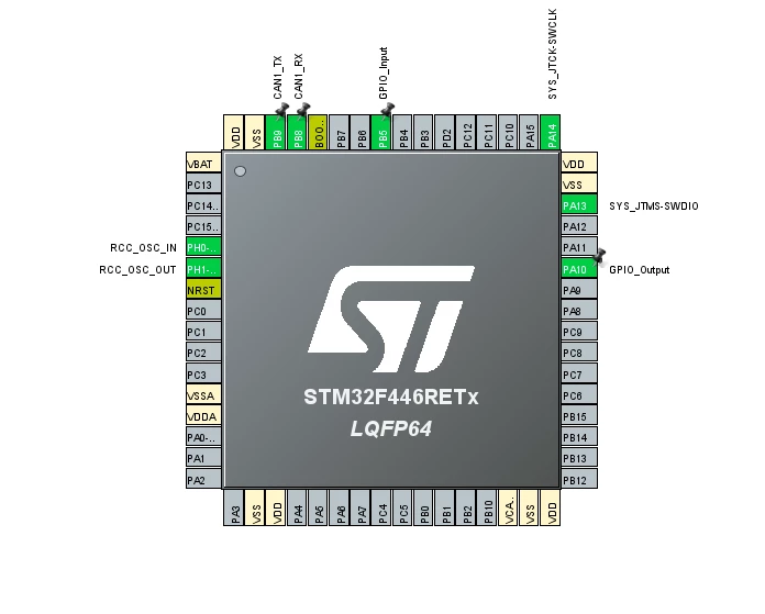

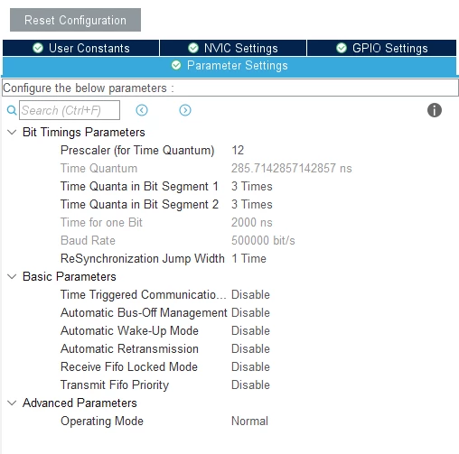

I am trying to build a part of the project.I want my three microcontrollers to communicate with each other via CANBus.What i am trying to achieve in this part is reading the digital sensor value from my hall effect sensor and sending this information to the other controller but for now just to see if it is working i am using a Waveshare USB-CAN A,CANBus adapter before conencting the second controller to observe if the project is working so far.I am using a MCP 2551 transcevier and I also connected the 120 ohm resistor between the CAN H and CAN L.I checked the resistance with my multimeter and I get 60 ohms in between them,as i should.
 The problem is when I click the debugger even the LED that i connected to test how far my code goes in debug never lights up.It doesn't even blink for the first line of code int main().I don't understand the reason behind it.It might be about the CAN and adapter settings,clock configuration etc. but i can't tell for sure.Just to let you know,I also checked the voltage values to see if my sensor and transcevier gets the correct voltages and they do.I also don't think it is an issue but I connect the adapter and the controller to the same PC.There is no data showing in the adapter and its CAN H and CAN L lights don't even light up meaning it doesn't most probably detect them.
I can give you more details or share more photos if you wish.I'm a begginer who is trying to learn through videos and forums so I'd really appriciate it if you can help me understand what is wrong and teach me how to fix it.

For the CAN bus i don't see a obvious error, when You single step with the debugger do You get in some error state?
