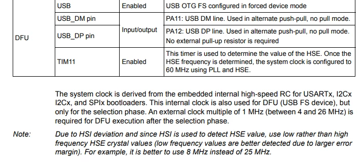

I am a noob in electronics and i am trying to make a quadcopter drone.
I found about stm32f411ceu6 inav firmware on internet github.
I only used arduino before and this stm32f411ceu6 was my first one.
I connected it with my laptop in dfu mode and used impulseRC driver fixer to install dfu driver and it worked perfectly.
Then i installed the inav firmware.
Detailes: https://github.com/rizacelik/STM32F411CEU6_INAV_Firmware
I can now connect as com10 port and inav configurator is working fine.
But i now whenever i connect my stm32 in dfu mode my windows wont recognize it.
It boots into dfu a pop us shows usb device not recognized.
Basically i cant access my microcontroller in dfu mode for firmware updates.
Can anyone please help me?

Hello @AyushZone and welcome to the Community :)
Are you using an external HSE oscillator?
Check this Application Note AN2606 which provides details on STM32F411 configuration in Table 67. STM32F411xx configuration in system memory boot mode.
