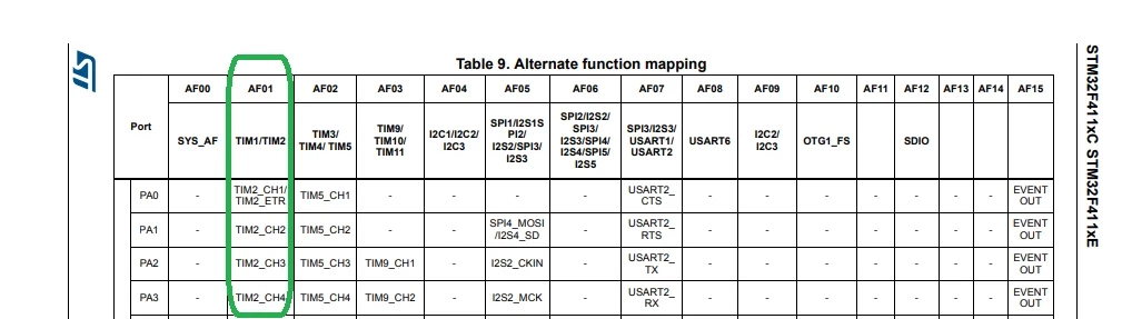

This is my first time getting below the Arduino level of embedded really - how exactly do the Alt-Function things work? I'm having trouble parsing the datasheet into understanding of how I should know when to set AF in GPIO_MODER and what the settings of GPIO_AFR[] even mean - how do I know what function is what, and where, and what AFR should be?
I see the Alternate Functions and Additional Functions on the datasheet, but where should I be looking to know what bits should be set to connect, say, PA1 to TIM2_CH2 versus PA1 to TIM5_CH2?
Tesla DeLorean
Guru
November 3, 2022
The AF setting is a pin mux, associating a pin with a controlling peripheral
The setting is 4-bit allowing for up to 16 options.
PA1 would be GPIOA->AFR[0], bits 4 thru 7
0693W00000VOqO7QAL.jpgGPIOA->AFR[0] = (GPIOA->AFR[0] & 0xFFFFFF0F) | (1 << 4); // AF1 on Pin 1

Oh, I see! So setting GPIOA->AFR[0] is the AFRLow and GPIOA->AFR[1] is the AFRHigh?
